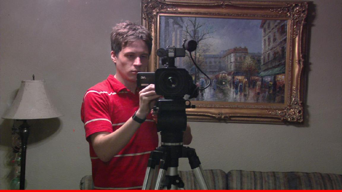

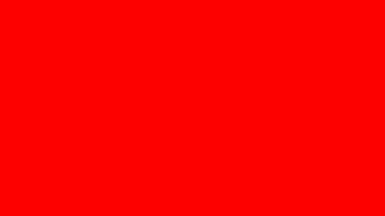

Tried another JVC proHD tape and a Panasonic tape. Both have the same problem, in fact, the Panasonic tape had the red frame...
I've attached two captured frames. bad1 is a good frame, then bad2, as you see is just bright red, and it lasts for 6 frames.

That is what happens to me, only mine lasts 9 frames. I was told it was an issue with the CCDs, and they're sending out a fresh cam.

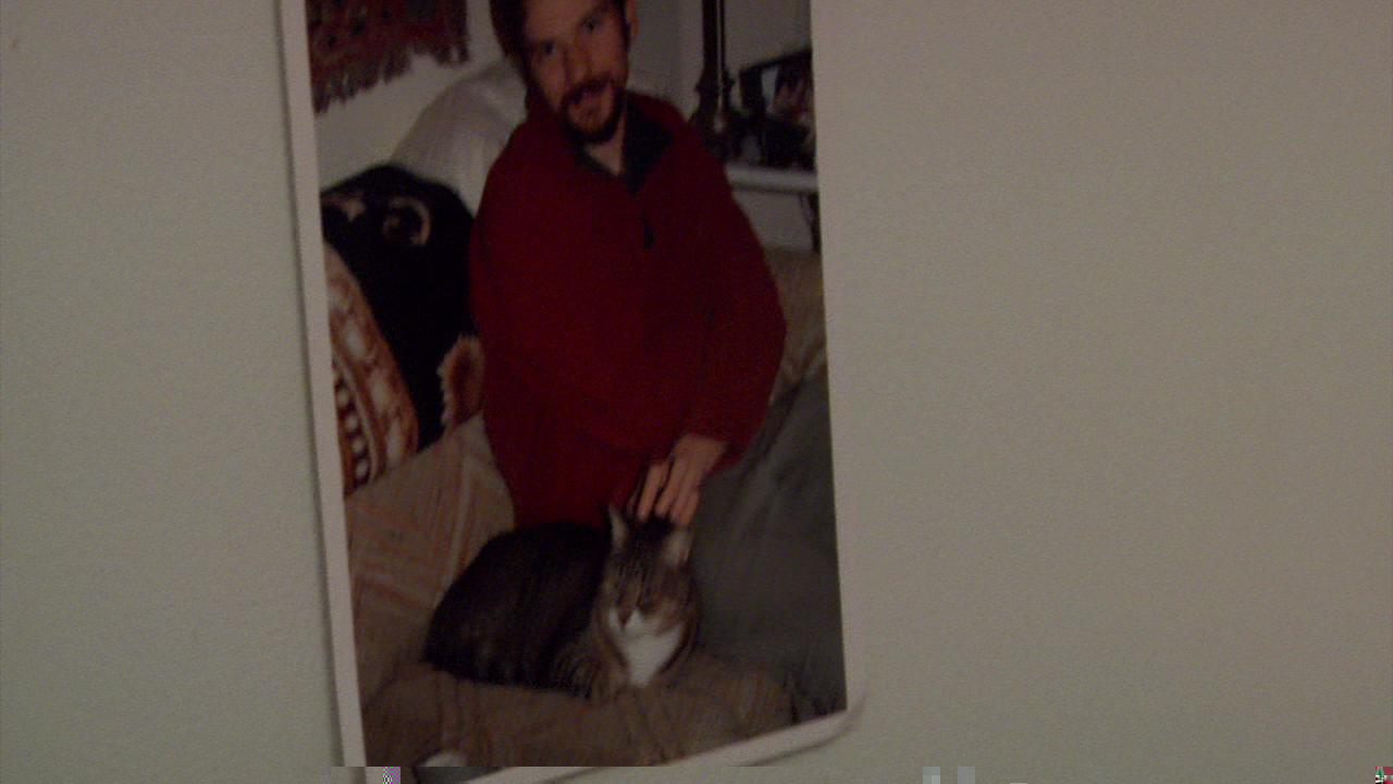

Wow, I wonder if I have the red problem. I have not seen any pure red frames but I was looking threw some footage and found a single frame with a line of red going threw the bottom. I looked everywhere and checked other projects for this red line but couldn't find anything. Hopefully, this was a rare incident.
