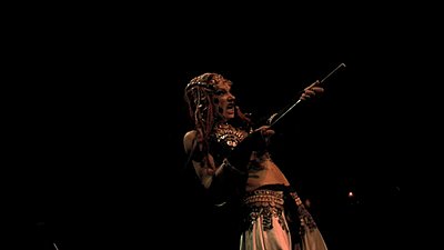

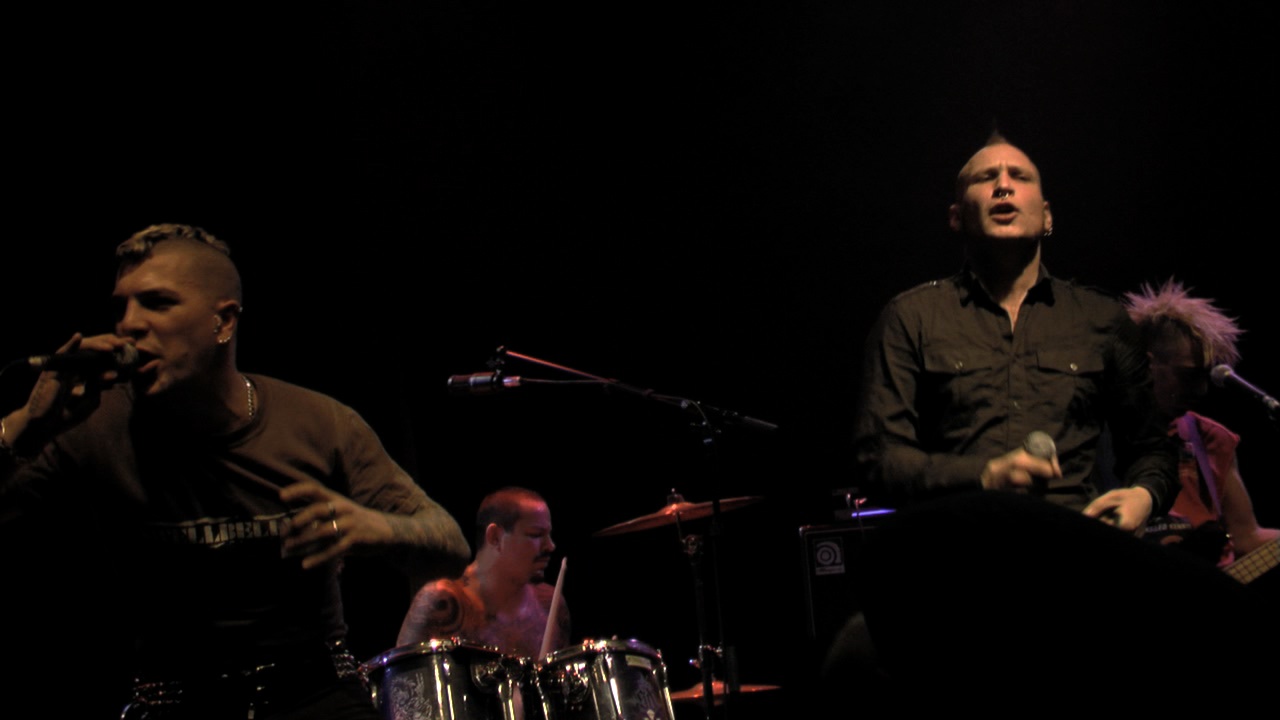

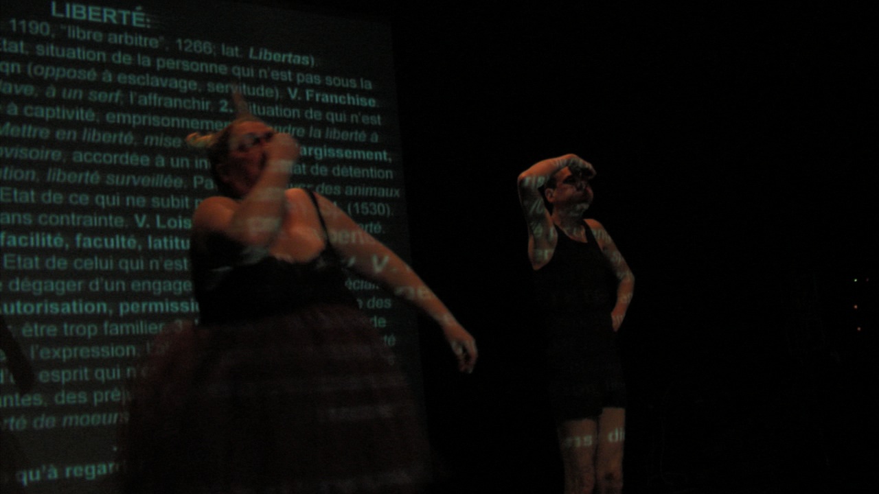

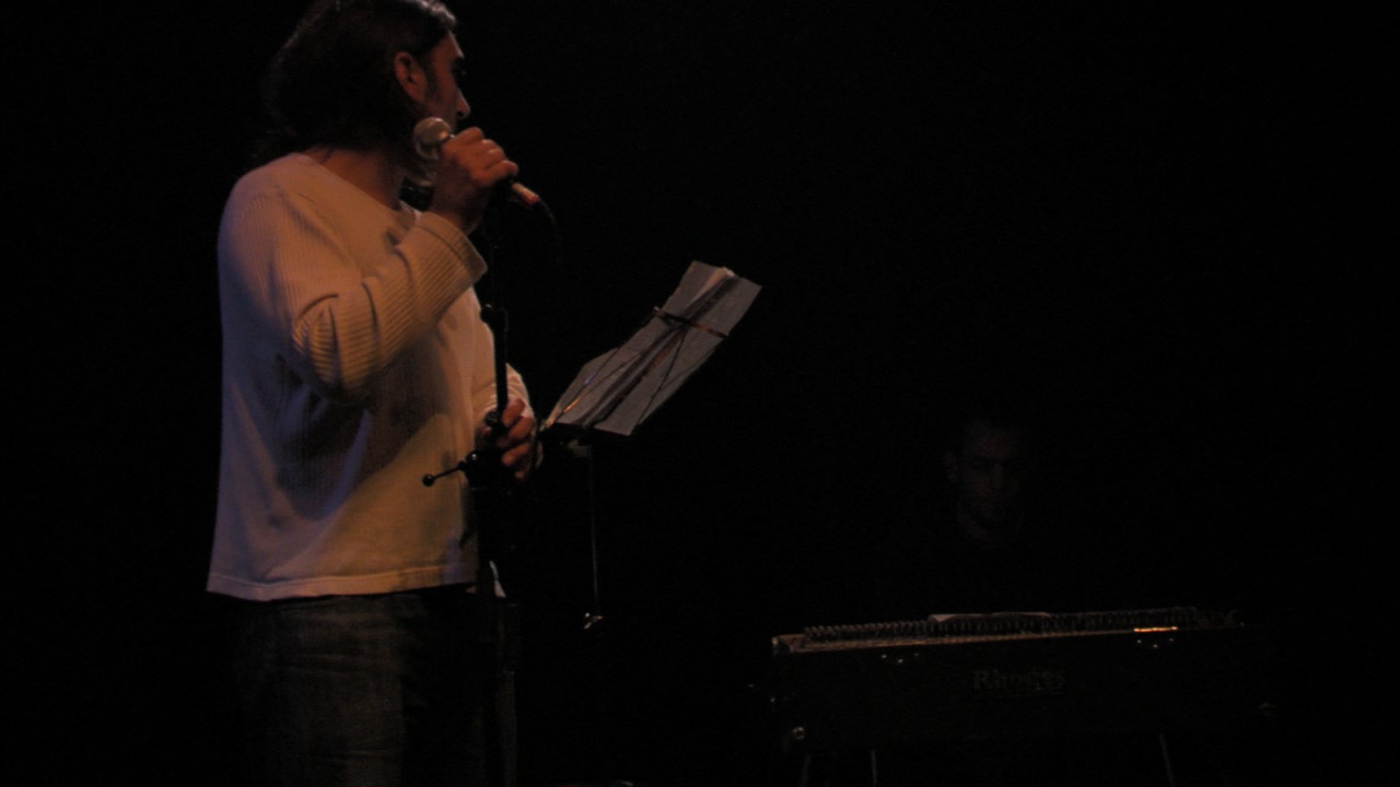

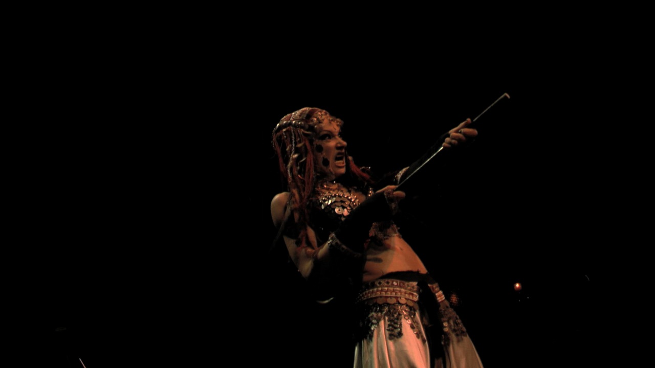

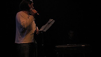

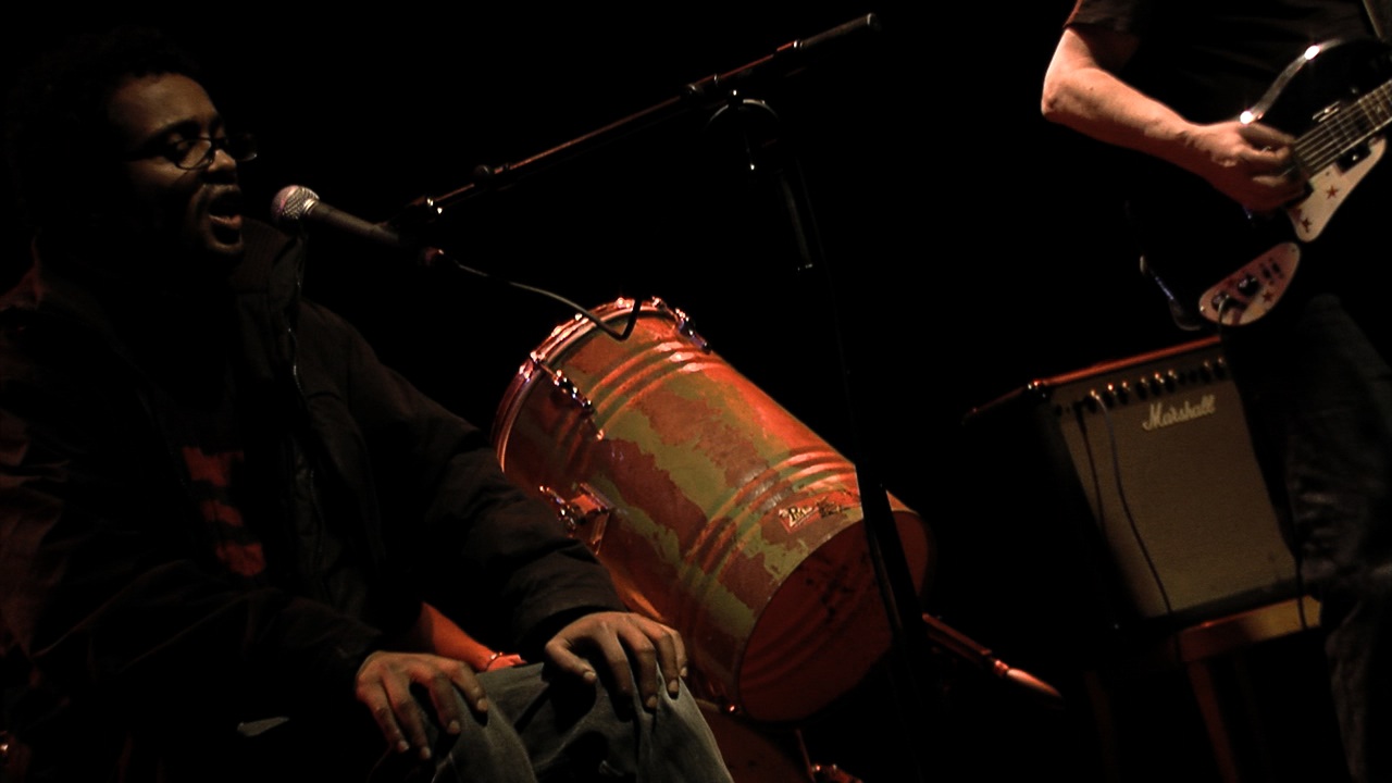

here are some screenshots of the various (experimental) performances.
There was almost NO light at all - sometimes only the light from the beamer.
we all felt the camera recorded pretty well under such circumstances.
shutter was 1/50, with the exception of the sisou performance where it was +/- 1/60.
lens was mostly full open.
any comments ?
Theater performance: which scene file ? (251, stock lens)-filmon_superw_mod.jpg   Theater performance: which scene file ? (251, stock lens)-sisou_superwide.jpg
Theater performance: which scene file ? (251, stock lens)-fautedefrappe_lowlight.jpg   Theater performance: which scene file ? (251, stock lens)-loulou_pier_lowlight.jpg
Theater performance: which scene file ? (251, stock lens)-kiko_thierry_lowlight.jpg
Claude Mangold is offline   Reply With Quote
Old January 5th, 2009, 05:35 PM   #6
Join Date: Sep 2002
Posts: 4,088
Claude, all things considered, those look pretty good. With a three way colour corrector, you should be able to pull a bit more from the dark mids and still keep the jet blacks.
Edit: Just realized the scene was noted in the file name. I think the Superwide is giving you a bit more to work with and a wee tad less noise to boot.
