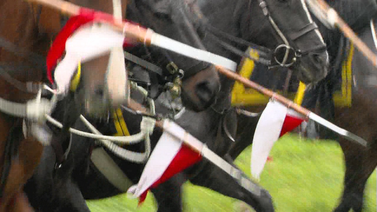

I've just returned from shooting a commercial using a hd200e and am overall very happy with the images.
However, one scene involved shooting a group of galloping horses from the back of my vehicle. The footage in this particular scene is dreadful. It's pixelated and looks like it was shot with a good mobile phone.
I've never shot any fast moving objects with this camera before so cannot speak from experience but have I just uncovered one of the limitations of HDV or this camera?
The scene was shot using 50p.
Any ideas?
note: I should add that the grey streaks you can see are rain. It was pissing down and wind speed was about 50kph. The vehicle was travelling at about 50kph.

Thats just HDV compression for you. It cant handle lots of motion in the frame, especially at the 50/60p rate.

The GOP is twice as long in 50P or 60P mode so there is more chance of this type of blocking happening during fast motion. The idea with Mpeg2 is that it is efficient for encoding, storing, and playing back motion images but it not ideal for frame grabs of motion.
Your example is about as bad as it gets for HDV1.
JVC uses 6 frame GOP for 24P, 25P and 30P and 12 frame GOP for 50P & 60P. The data rate is always 19.2Mbps regardless of frame rate (HDV1).
If it is any consolation HDV2 (1080i) breaks up even worse when encoding fast motion, even though it uses a higher bitrate (25Mbps.)

Roto refers to the sequence as a whole. This is a cutaway from a locked off shot where we roto 6 horses charging toward camera and duplicate them into about 60 or so. So, as these moving shots are only to be used as very fast cutaways I think I'll get away with it. (just)
