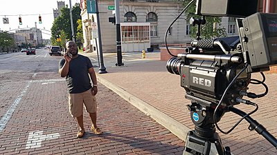

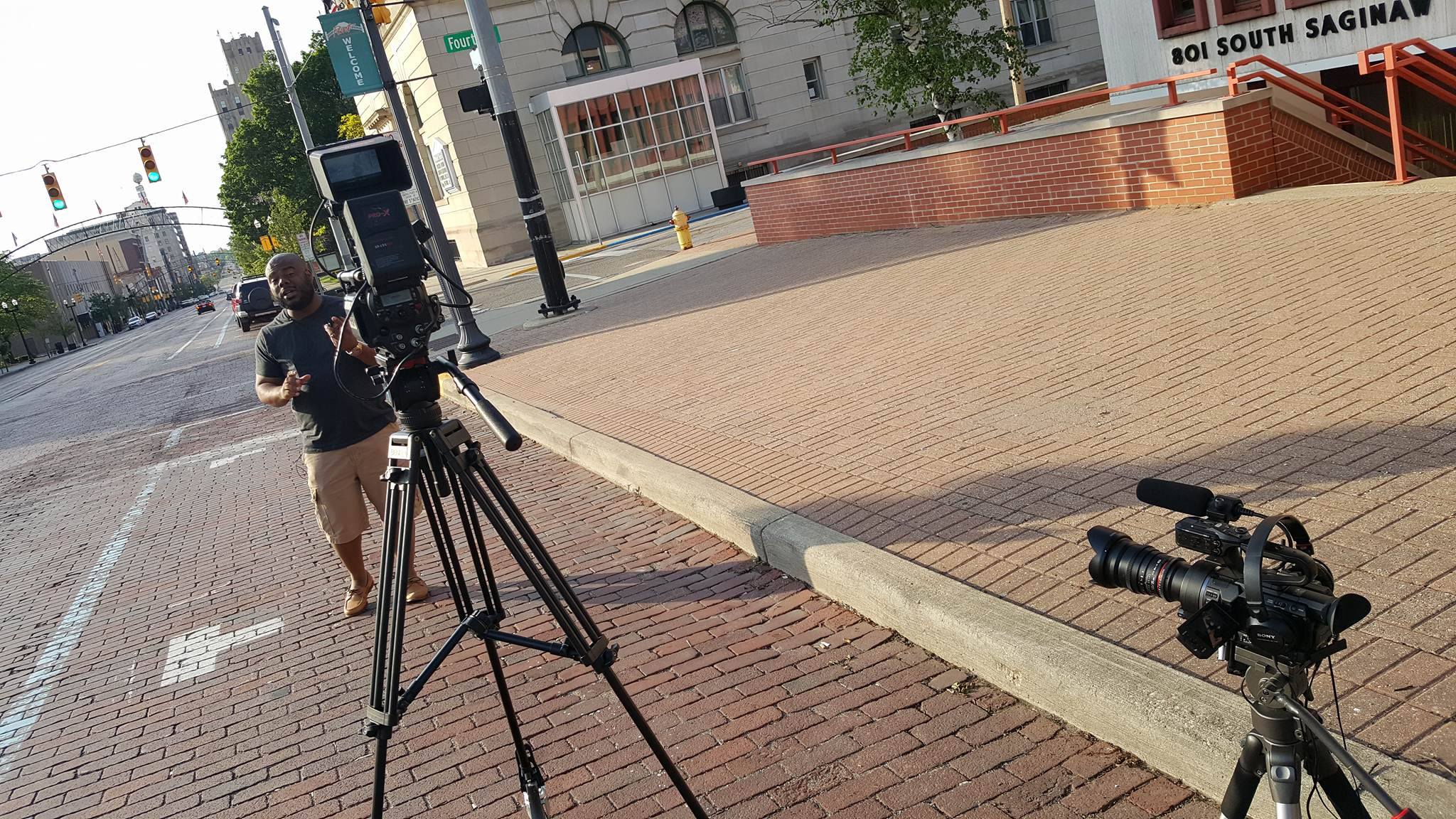

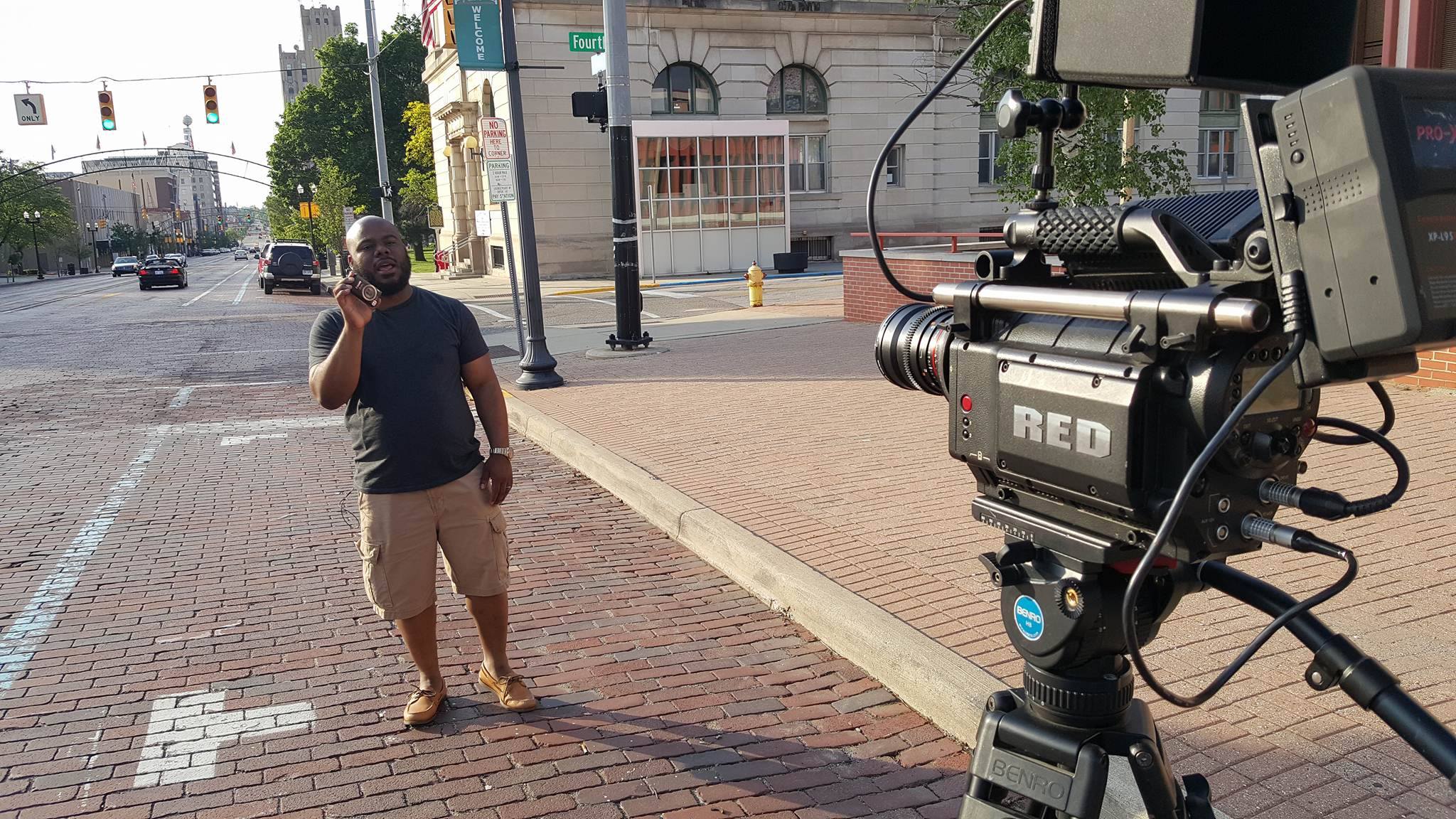

I went out to shoot part of my TV show promo down town Flint, MI. I under exposed the footage and it turned out horrible. I was shooting in Log outside with the sun out and I wanted to keep definition in the clouds and have good exposure of my talent. It did not work for me at all. I learned a valuable lesson yesterday.
To be clear it was not the camera's fault it was solely my mismanage of the exposure. I had the RED out shooting as well using it as cam A and the LS300 as cam B. Both were underexposed. On the JVC histogram I was peaking in the white and a low valley on the mid tones and peaking in the darks. I adjusted the aperture to have the white peaks to the right but not clipping to keep the sky information. Let's just say I bombed that session. I'm glad it was not a paid gig because it would have been horrible to explain to the client that we have to re-shoot over again.
Another thing that was plainly obvious is that I need a matte box on these cams when shooting outside.

The sun in those shots is angling down from the left of the frame. A large off-frame reflector on the right side could fill in the underexposed backlit shadows.

I had one but Im not sure if i was angling it right because I was filming, monitoring sound, and holding the freaking reflector. Again, all my fault.
One thing I notice is the ND gives off what seems to be a blue tint. Is anyone else noticing this with the LS300.

A matte box might help but this is the sort of situation that a single person crew will have lots of problems in. Direct sun is always a problem.
I filmed in a similar situation a year ago with a small crew (one audio person, one cue card holder) but not enough to assign anyone reflector duty. The shots required the talent and the background be clearly exposed. It happened to be a hazy day but not overcast so the sky was not deep blue but a bright blue grey. Back lighting the talent wasn't go to work as that underexposed the talent so I had to compromise with harsh sun on the talent's face but at least everything was in reasonable exposure. I played with color correction a little, applied a film grain filter and it worked out. I still wish I could have used the reflector but there was no way to keep it from flying away in the wind. Sometimes the sun is so strong that one reflector isn't enough to raise the shadows.

At that location you'd have to shoot in the mid-morning to have the sun in the "traditional" lighting position for your subject.
There may have been other considerations or limitations that locked you into that time of day shown in your photos, but I always try to visit outdoor locations in the days before a shoot at the time of day that is planned.
If that general spot, direction and time of day were unchangeable, could you have backed up about half a block? I ask because the tall church diagonally across the street is casting a shadow all the way over the full sidewalk.
Looking at Google streetview, the only other high structure just to your left and behind you is the Arts Council building that may have been just tall enough to keep your subject out of direct sunlight.
As you've already mentioned, a good matte box for the lens is important. I'd also add having really good shade and hooding for your monitor or viewfinder is important. Sometimes you have to judge the mid-tones by looking at the best monitor you have by eye to see what really works and not let the histogram be dominant in your adjustments.

That being said I think your shooting was probably just fine for Rec709, but for Jlog the mid tones should be higher. I also shoot at ISO400 not the recommended 800 since more grain shows up faster at 800ISO.
