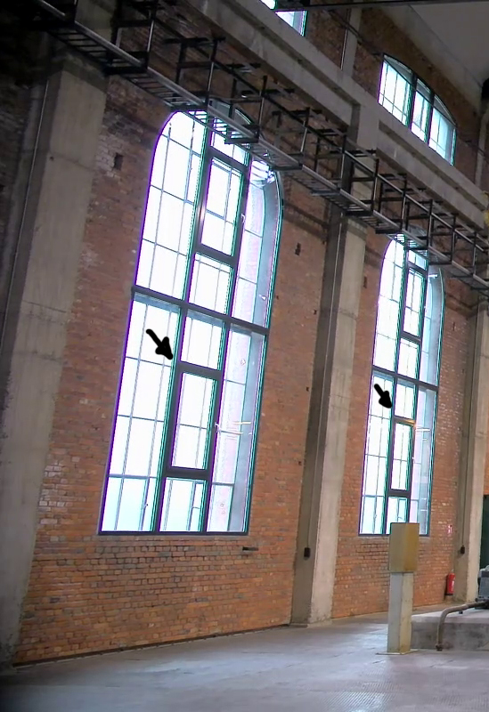

I already shot a wedding with this camera and then I didn't notice anything weird but when I just received the camera I made a test film with a slider and I noticed a artifact that I was able to replicate today, because I have to shoot with that same slider this Saturday and because it's also architecture I have been looking into decreasing that effect today.
If you look at below video starting at 01:21 when I do that sideways slideshot in that big hall, look at the big windows at the left and see how visible that aliasing is on vertical lines in those windows.
Originally I thought it has something to do with the downscaling from c4K to HD but during some tests today I noticed the aliasing on edges is visible in every shooting mode, only when I shot in Jlog the aliasing almost completely disappeared. What did help to reduce that effect considerable was to decrease the sharpness to at least -5.
Are there others that see that same problem as well? I wonder if there is any difference if you use lenses that use the entire sensor.

The aliasing I am referring to can be seen in the screengrab: it's particular visible on vertical lines and gets very visible when there is controlled cameramovement like on a slider.

Here is a part of the video that I have enlarged which clearly shows the problem, you have to bear in mind that this comes from a c4k source, was then downscaled in post to 1080p and then uploaded to vimeo where the further apply compression to it.

noa-
i appreciate your efforts to create conversation about the effective use of the ls300.
i am a fan of your "luchtfabriek" piece.
i had previously "liked" it on vimeo.
but this morning, i was pixel peeping to see the concerns you raised.
i also saw at 01:18 the arched window on the right had some funkiness.
as you suggested, i wonder if lowering the detail and/or the use of jlog will eliminate these issues.
that said, i initially watched "luchtfabriek" twice on vimeo and didn't "see" any issues as i was so involved in watching your work.
pixel peeping is helpful and often necessary but plenty of times only we see what others don't or don't care.

As for aliasing, the LS is way less than the BM Pocket Cinema Camera (I own two) which everyone raves about - even in a non-log mode.
However, from the start I have thought the detail is really amped on every camera I see from a major manufacturer - it's like the 4K TVs at Costco, they make your teeth hurt.
If I'm shooting Cinema Gamma, I dialed the Detail down to -10 or -12 (I don't remember now). However, since the firmware upgrade I have shot exclusively in log, and as you pointed out, the aliasing virtually disappears. You can't adjust the Detail in log, so it's only a guess, but I'd say it's down to about that -10 -12 I was using originally.
I realize weddings can be a problem - mothers of brides want to see every detail. But for my work, documentaries and doc-style TV spots, I prefer the detail to mimic a 1/2 SoftFX on 35mm... It's just nicer.

"this comes from a c4k source, was then downscaled in post to 1080p and then uploaded to vimeo where the further apply compression to it."
When you downscale you are at the mercy of your NLE scaler. Worse, CK4 has to be scaled to go into either UHD or HD. Hopefully you simply cropped the image. CK4 and CK2 are ONLY to be used when creating a production for digital movie projection.

Lowering the sharpness doesn't make much difference for a weddingvideo, at least not to the client as I find the perceived sharpness even in HD to be more then sufficient. It only looks the jvc is oversharpening things even when sharpness is set at zero but I didn't see aliasing then, there is one shot of the church on the outside and it has very small bricks and even those are displayed without any aliasing.
I think that's the case too, just by visually comparing when I shot in another preset then jlog and when I turned the sharpness to -10 it looked the same as Jlog.
