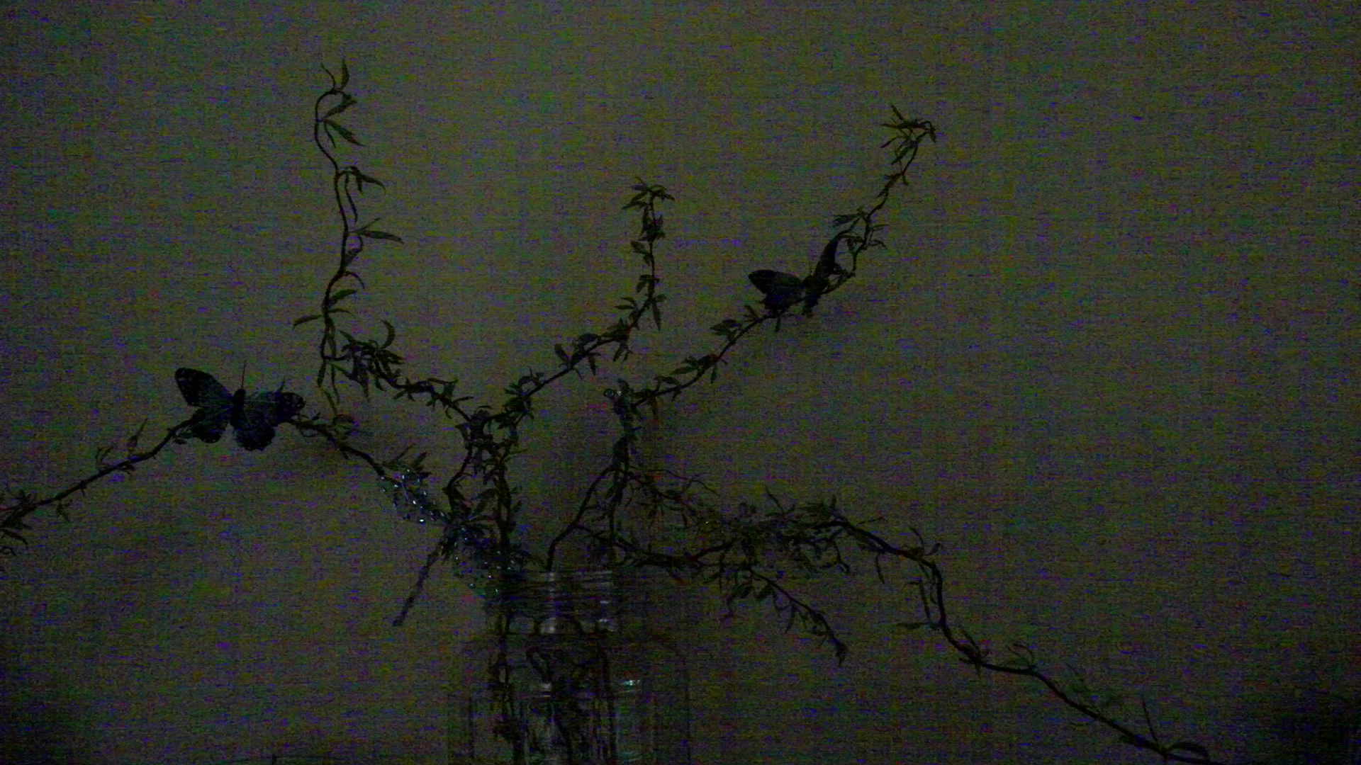

Attached is a shot of the ls300 at 6400iso, I know it's much underexposed but this is just to show what kind of noise I saw in the shadows on a shot taken indoor with a window in the frame and part of a indoor wall where I exposed for the window.
Thing is, I"m not getting the same problem now so have no idea what has caused it before, so unless I am able to replicate it during any of my following shoots I have to reconsider my thoughts on the noise level of this camera. I"ll just have to wait and see. Maybe the camera just needed some warming up. :)

I've had a couple of FPN issues as well, less than with some other cameras - and certainly not as distressing as, say, the moire on Black Magic footage. But when that noise does happen in the shadows, it is distracting enough to draw the eye... not good. The suggestions for avoiding it above are good ones for - as I said - any of the myriad of large sensor cameras that do this... however...
I once had a similar (although not as bad) issue with my Canon C100... because I forgot to black balance after changing lenses. Canon advises doing that, not because of a difference in the lenses, but because it can forget what black is. Unfortunately the LS300 doesn't have a black balance function (I'm told it does black balance automatically when booted, but I haven't seen proof of that).
