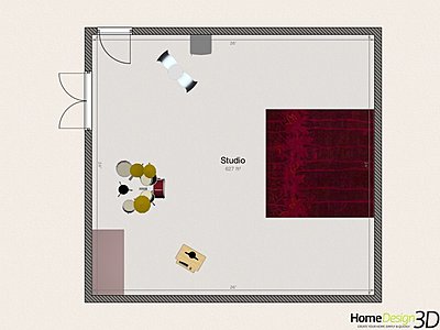

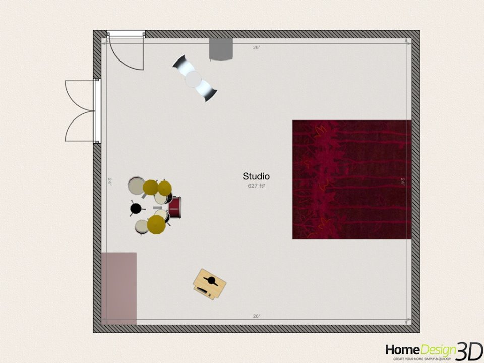

Re: New Studio Plan. Brainstorming.
So I think this is the plan. It'll have 13'' cathedral ceilings inside. Six foot closet, two doors. The large square represents 10 feet out from the wall for backdrops and such.
