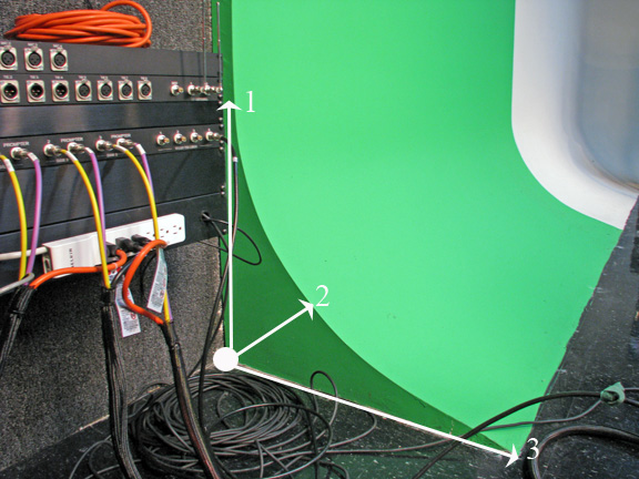

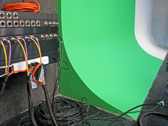

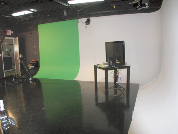

Here are a couple of shots of our cyc wall; Dean's detailed description give a good idea of how this one was done, also ---plywood verticals cut to form, hooked together with horizontal stringers. The drywall was cut as I described then covered in drywall compound and sanded to shape. The flexible drywall mentioned is a new one on me, but it sounds interesting. Hope this is some help, I'm sorry that there aren't any photos from the actual construction..../ Battle Vaughan/miamiherald.com video team

Need a couple measurements
Battle:
Thanks so much for the pics, Im getting a better understanding what i need . I am wondering if I could bother your for onoe more big favor. Would you be able to get me the measurements I need.
Pic 1 is from the floor to the top of the plywood support where it meets the 2x4
Pic 2 is the widest part of the radius
Pic 3 is from the wall to the end of the cyc.

Dimension 1 is 24 inches; dim 2 (from corner to the radius, as you have it drawn) is 14 inches and dim 3 is 32 inches. / bvaughan
