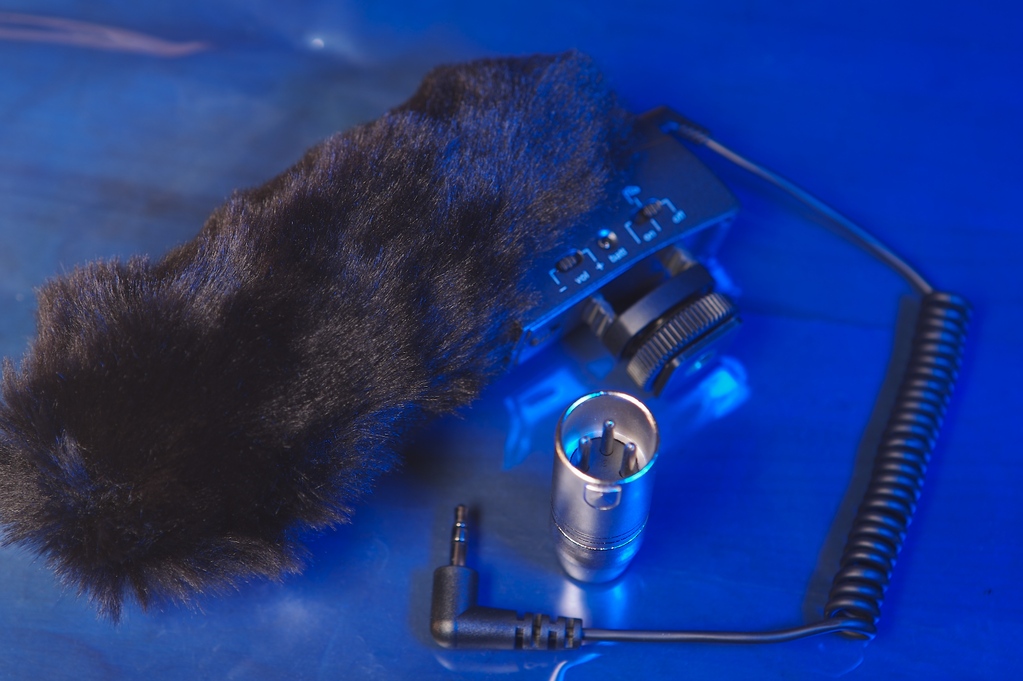

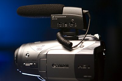

Since it sounds like this isn't for a full on pro production, and more just for getting the feel, I would suggest the Sennheiser MKE400. That's what I pack personally on run n gun shoots. It's super small, yet yields a decent sound. It's one of those things where comfort and speed rule. I can pull out the camera and set-up quick and be totally unobtrusive. Yet, if I need to I can put a quick 10' extension cable on a K-Tek traveller boom or place the mic on a small tripod (it has a 1/4"-20 thread on the bottom). The windmuff is also very good. This mic is tuned for dialogue and will sound better than a RODE Videomic for voice. See this quick vid to see and hear a sample on the Canon HV20.
Sennheiser MKE400 and Litepanels Micro on a Canon HV20
If I'm to be a "fly on the wall", storming in with a full sized camera, lights blazing with a boom op creates a different atmosphere in a lot of situations. People just act different. The link above with the MacVideo interview says a lot. Worth watching. 100 countries, that dude is worth paying attention to if you're embarking on a similar adventure (Richard, thx for sharing this)
Great still images and a high quality audio recorder like the Sony PCM-D50 might be another option. I have a friend that produces a lot of content this way (BTW, their team just won another Emmy). See MediaStorm: A Multimedia Production Studio Founded by Brian Storm - Photojournalism, Photography, Video, Audio, Storytelling
Advice on gear for solo travel doc around SE Asia-mke400.jpg   Advice on gear for solo travel doc around SE Asia-pi5j4389-version2.jpg
