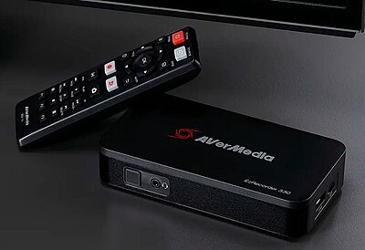

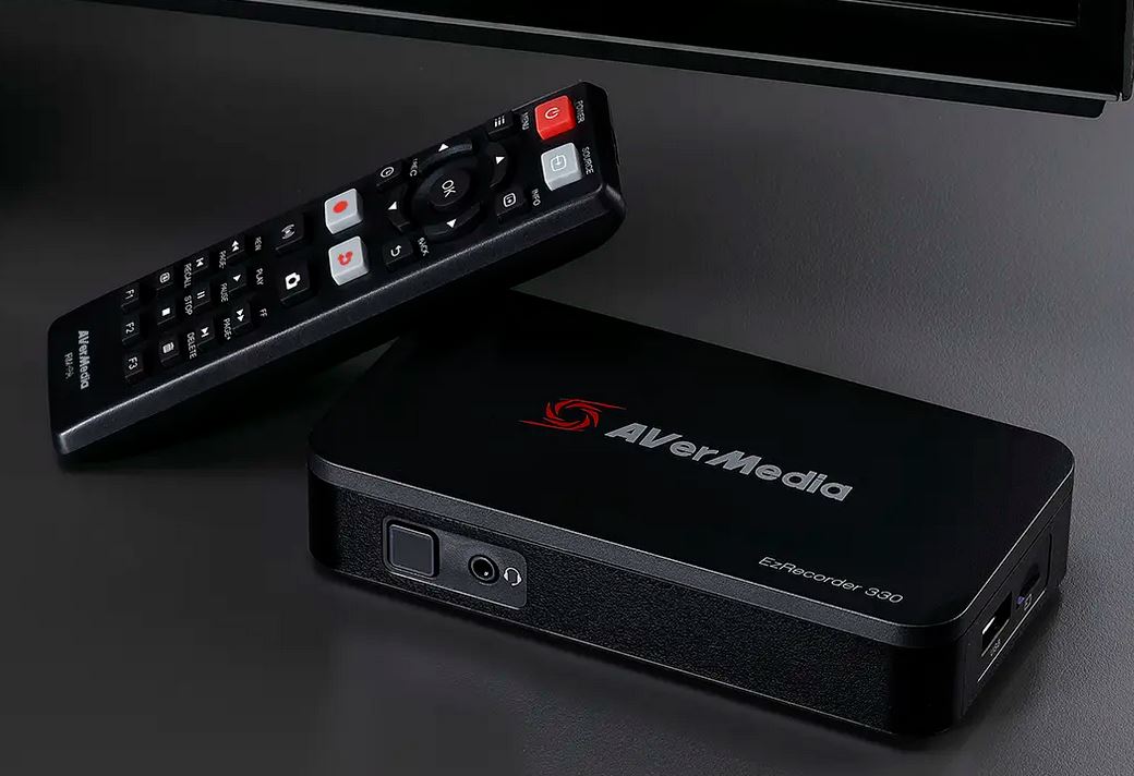

If any of your camera kit has an HDMI out, you should be able to capture straight to any HDMI recorder. Or at least I would imagine so. I have a Sony HVR-M25E which has HDMI out and the output can be captured with an Atomos Ninja V so can be captured as either ProRes or H.265 depending on the Ninja's record setting. It can also do a hardware up convert from SD to HD 1080i in the process.
Alternatively:
If you want a cheaper HDMI record solution, around US$130 from Walmart... before tariffs I guess, you could try an AverMedia EzRecorder 330 - ER330 which can take in any of the following formats. (Video Input): 2160p, 1080p, 1080i, 720p, 576p, 576i, 480p, 480i. It does a decent job of converting interlaced inputs to progressive. You can record to Micro SD cards or SSDs. It will NOT record to USB thumb drives.
Though it will take in and pass through 4K, it will only record in HD up to 60p. There are three different compression rates in either H.264 or H.265 to record in. Both H.264 and H.265 goes up to 40 Mbps. In H.265 the 40 Mbps setting gives you a very decent quality image that edits quite nicely in Resolve.
HINT: With an intelligent HDMI splitter it will allow you to record off-air, satellites and streaming services. I have one permanently installed in our main home AV system.
