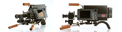

No-one's mentioned the [url=http://www.siliconimaging.com/]SI2K[/ur]. The heads are around $15K, or were according to a price list from 2007. Not sure what they are now, nor how much it would cost to get a shooting rig together.
Another suggestion would be an Indiecam POV set up mounted on a suitable camera rig.
I can't remember how much the heads are, but I recall them being around €10K from my discussion with their rep at the BVE show a few weeks back.
Both of these use 16 mm glass, and that's increasingly cheap because no-one wants it these days.
