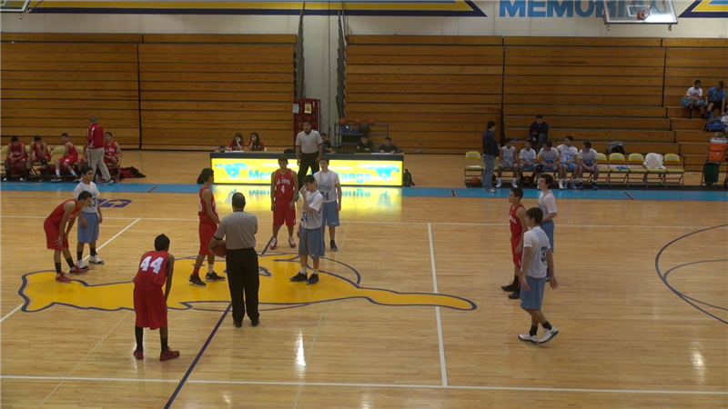

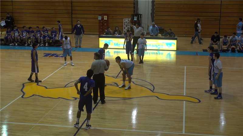

Here are two different pics from the same gym same location and the only difference in the settings is the WB. As you can see the scorers table I am dealing with a very problematic light source. First pic everything is on Auto and the second pic everything but the WB is on Auto.
Expodisc and WB-vlcsnap-2012-01-09-09h32m04s55-medium-.png   Expodisc and WB-vlcsnap-2012-01-09-09h30m56s103-medium-.png

Wow........................
What an astonishing difference between the two pictures.
If ever there was a "seeing is believeing" sales pitch for the ExpoDisc, that second one is it.
I think you're being exceedingly modest with the term "problematic".
CS

First, other than brightness, I see little discernible difference between the two frame grabs (well, okay, the one on the left is indeed a bit bluer). The color looks similar overall, though, and as the Manual WB and the Expodisc would only affect color and not exposure, it appears that neither are helping you at all. The Auto WB on the cam is averaging all the colors in the frame, and all the Expodisc appears to be doing is basically the same thing by using incident rather than reflected light (because it's not getting fooled by the warm tones of the floor into shifting everything towards the blue end of the spectrum -- but you could accomplish this with a sheet of white paper).
Secondly, using only Shutter to control your exposure is a Very Bad Idea. From moment to moment, your motion will change, going from the stuttery stroby "Saving Private Ryan" look when it's bright and you've forced the cam to use a short shutter speed, to oddly blurry when it gets darker and you've forced the cam to go down to 1/30th or even 1/15th. Your video will look terrible. There's a reason all these consumer handycams are programmed to move the shutter speed absolutely last, when changing Iris and Gain are not sufficient. And it won't solve your problem -- the cam will still be seeing that board and will try to darken the picture. And at that distance, DoF is a non-issue.
That backlit adboard is definitely a problem. But your cam has a "Backlight" mode (P. 36) which will easily compensate for this. But every time that board comes into the frame the cam will still try to compensate. On the 560, you can assign EXPOSURE to the manual dial (P. 41) and lock the exposure completely, if I am interpreting the sometimes cryptic Sony manual correctly. If this is true, you should set a manual WB and let the cam find the right exposure before you begin shooting, making sure that backlit board is not in the frame. Then lock the cam on MANUAL by pressing the Manual button in the center of the Manual dial, and then begin shooting. You must choose MANUAL before shooting, according to the note on p. 41. If this does what I think it does, it will lock your exposure and will not try to adjust when that board comes into the frame. If the board were always in the same part of the frame and you had the cam static at all times, you can just use AE SHIFT to compensate for the board, but as I assume you are panning to follow the action, the moving board will always cause you problems as it appears and disappears and even changes position in the viewfinder (as metering systems focus mostly on the center of the frame).
Unfortunately, there are no cams yet built that are smart enough for you to tell them: "Ignore that really bright sign" and have them understand and respond appropriately. The only way is to totally lock the exposure and control it manually. But you can use SPOT METER (P. 76) to meter for objects that aren't the board. And you can ride the exposure manually just by using the + and - buttons on your LCD (P. 77).
