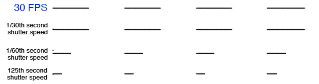

Thanks for the teaching aid! I think what I was trying to illustrate in my above post is exactly what you are trying patiently to explain. Because of the format issue, my diagram makes it appear that there is more than one shutter exposure per frame, which was not my intention.
MAybe I'll redo that in photoshop quick.

Ok. Here is my chart as I had originally intended:
Jonathan Levin is offline   Reply With Quote

Location: Springfield, Missouri
Posts: 117
Yep, that looks about right! :D
