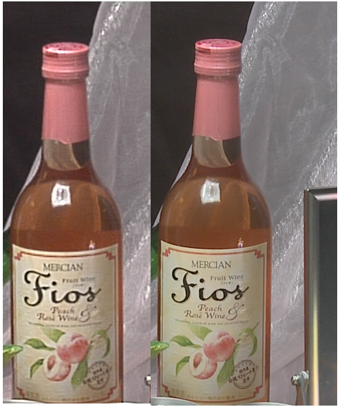

It's true the HPX500 is an amazing camera. The new HPX200A is an improvement in picture quality and noise over the older HVX200.
The problem is DVCPRO-HD is now an older codec. Yes, we all know many pros use this codec and the Varicam was a success.
I remember when the EX1 was first compared to the HVX200. There was a day and night difference in every aspect, noise, exposure, and especially resolution.
With the NanoFlash at $3.5K, this is a small investment that would offer dramatic codec improvement under fast detailed motion and improved keying.
This is reasonable considering the price of SxS and P2 memory cards.
EX-1/3 or Panasonic AG-HPX171E?-hvx200_ex1_bottle_1080_30p.bmp
