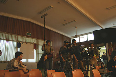

People have been able to get good quality when hooking these "sub 10k" cameras to a 35mm adapter, or if your able to rent out a camera, try using a Sony F900r or for the same amount just hire out a 16mm camera like an Arri SR2 mkII, they rent them out real cheap these days, My point is, there are alot of options, but they have been the same options given to me too, Heck I shot with an SR2 MkII and used my JVC HD100 as my B-Cam, after grading it in post, it was workable. So Try thinking outside the square dude, A good DOP tries to always make magic with what they've been given. If lit right these sub 10k cameras can produce awesome images, well good luck.
"eyes through a digital world"
