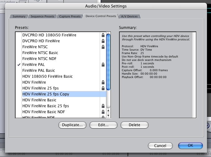

The best you ccan get from FCP right now, is losing 1 second on the beggining and the end of each clip (much better than 7, yet...).
You can do that by changing the the pre and post roll time to 1 sec, on "device control preset" - check out the attached screen grab. It's for 720p25, bu I suppose it works for 24p too.
Sergio Barbosa is offline   Reply With Quote

Thanks for the tip Sergio!

You're welcome... Just sharing what I've been learning from these forums!
