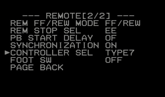

The decklink defaults to work with BetaSP decks and similar, but the protocol RS-422 default of the BR-HD50 doesn't work the same.
You need to set it to TYPE 7 for better RS-422 communication.

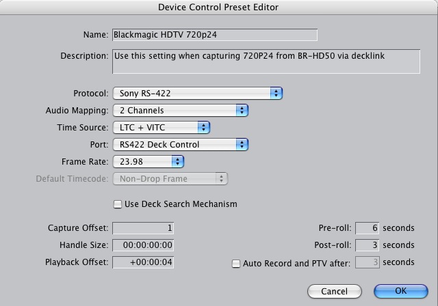

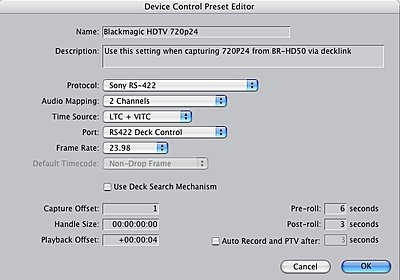

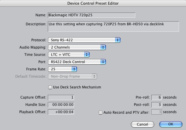

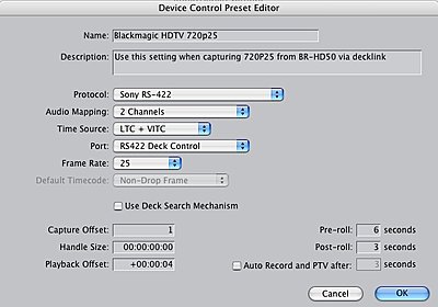

You also may need to create a custom deck control preset in FCP for 25fps TC from LTC/VITC. This worked for me and had no issues capturing with correct timecode.
