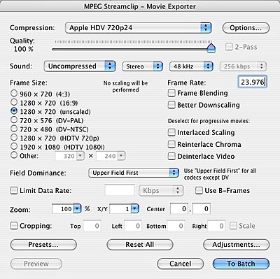

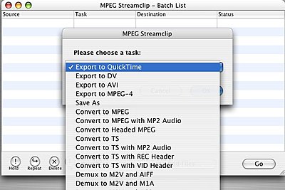

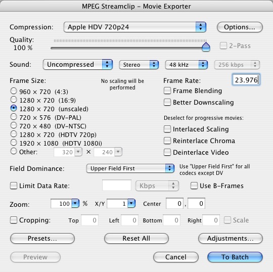

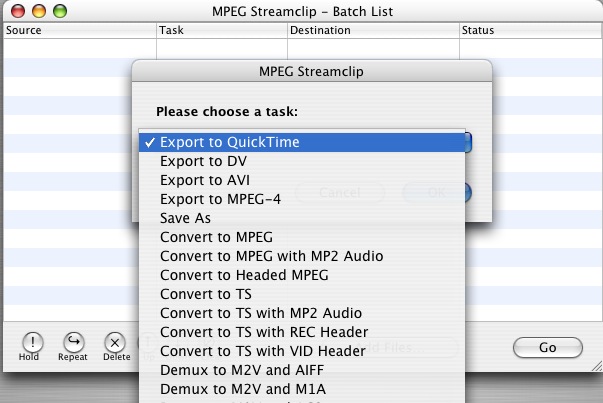

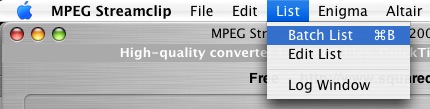

You can easily batch encode your 720P24 m2t files into a quicktime format with MpegStreamclip.
  • Select Batch List from the List Menu
  • Drag your m2t files into the batch list
  • Choose "Export to Quicktime" as the task (this should be the default.)
  • Use Apple HDV 720p24, Uncompressed Audio 48kHz, Frame Rate 23.976, and deselect all of the checkmarks.
That's it. You will now have .mov files that can be directly dragged into FCP and used in your HDV 720p24 timeline.
If you are unhappy with the recompressed picture, and want the best quality possible when it is time to online, you can use MpegStreamclip to demux your original m2t files into m2v and then re-link to your sequence, replacing the converted .mov files, then change the sequence codec to uncompressed 8-bit or 10-bit. After rendering in FCP into uncompressed (you will need LOTS of hard drive space) you can output via decklink or kona and compress for DVD, HD-DVD or Blu-Ray.
