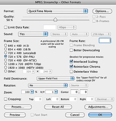

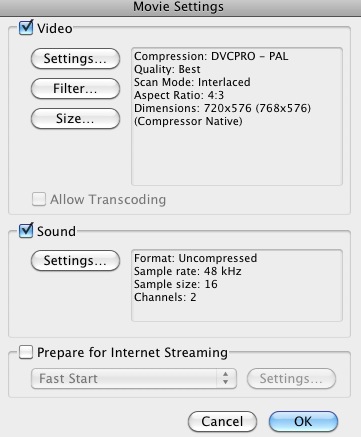

Rob,
I'm not sure I fully understand your technical quandary but, it seems you can save yourself a lot of headache without re-converting your clips at the end.
Since your'e ripping content from an authored NTSC-DVD why not just have MPSC convert those files on the fly into a PAL-compatible editing format, such as DVCPRO-PAL - or whatever editing timebase you're using? Then you won't have to make any further conversions at the end into your finals.
If you do that make sure you make custom adjustments in MPSC so that the ripped content matches your editing timebase in FCP so you don't have to render on import (see screenshot examples of DVCPRO-PAL). Most especially make sure your ripped files are 48Khz, not the standard 44.1 MPSC selects otherwise you'll have to render - and re-render all the audio both on import and after every edit.
Hope this helps.
