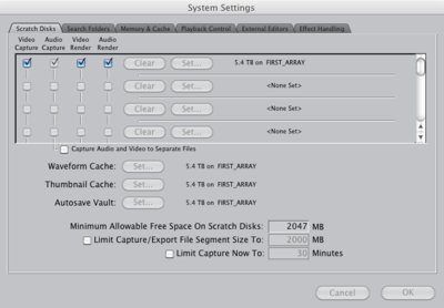

In Scratch Disks, did you UNCHECK the Boot Drive targets? When FCP first boots, it only knows the Boot Drive exists so it send files there. When you ADD a target, you need to uncheck the Boot Drive.

Attach a screen capture of your scratch disks screen and we can help more easily.

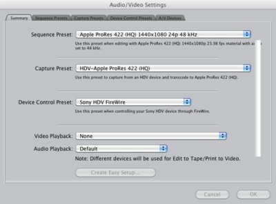

As I explained in my original post, the scratch disk location is not the real problem. The real problem is why are my media files, not media files? Why are they generic documents that are unrecognizable by any program, including the one that just made them (FCP)?
Importing Problems-scratch-settings.tif   Importing Problems-v-settings.tif
Importing Problems-media-file-icons.tif   Importing Problems-get-info-pic.tif

Originally Posted by James McCrory View Post
After doing this for about an hour FCP freezes. I press Esc, nothing happens. I click around but the program is not responding at all. So I force quit it. When I reopen it, all the clips in the bin are gone. I check the scratch folder and the imported clips are there. So I try dragging them from the folder to the bin, it doesn't work. I try choosing import, it doesn't work.
I notice that the files have a generic document icon. I click one and choose get info. It just says document and shows the files size, but doesn't say what type of file it is or what program it's associated with.
Were these all clips from ONE HDV tape that failed to be completely ingested by the time you Force Quit? If so, the header info probably wasn't written to the clips (which would happen AFTER a batch import as you are using an HDV to ProRes capture, which is a Capture Now setup).
Can you try capturing smaller bits of tape and see if the files come out ok? (I mean stop the import after a couple of minutes by pressing Esc and allowing FCP to finish writing the files).
