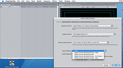

I BELIEVE the option you are looking for is here:

Shaun, I see those options and I tried each one them, but none shoots the preview window out to my TV.
Update:
Got It! Not only did I have to do what Shaun said, but I also had to go in at set: View - External Video - All Frames
Once I clicked "all frames" it popped right on and it looks great.
thanks!

Great news. Yeah, forgot about the All Frames thing... sorry.
