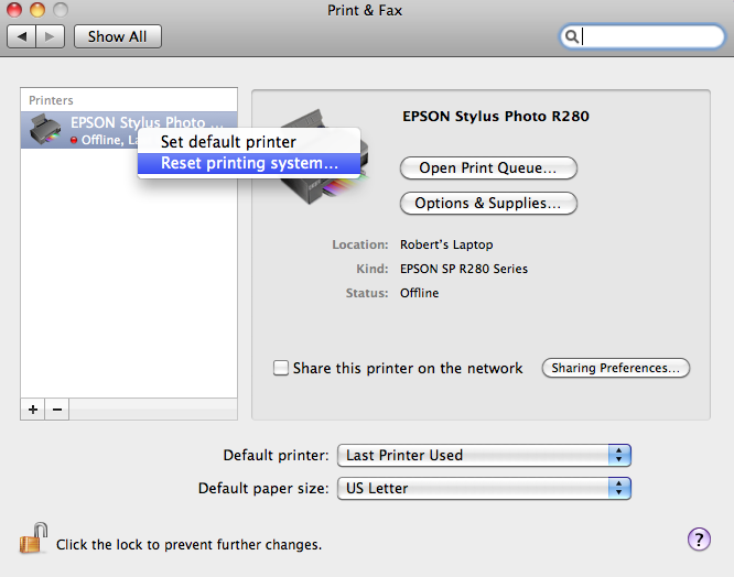

Some printers and scanners will require installing newer drivers to work properly however even after installation they may not communicate well. Do yourself a favor and prevent the long hassle of troubleshooting old vs. new: BEFORE you install new drivers go into your preferences and in the printer setup menu, right-click (option click) on the current listed printer/s and select "reset printing system" (see pic). This will dump all old driver code and force-refresh a new capture process. THEN install the updated SL drivers as needed (in some cases you might not need new drivers after the forced refresh).
