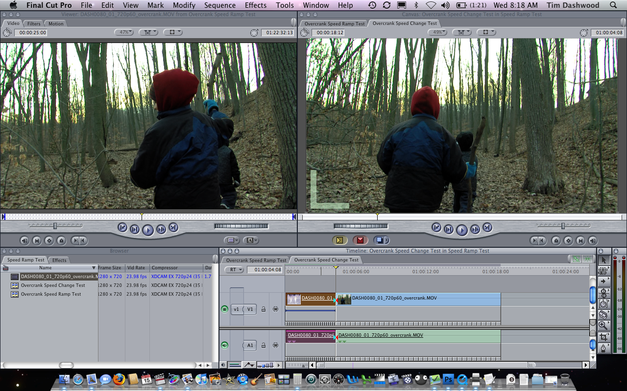

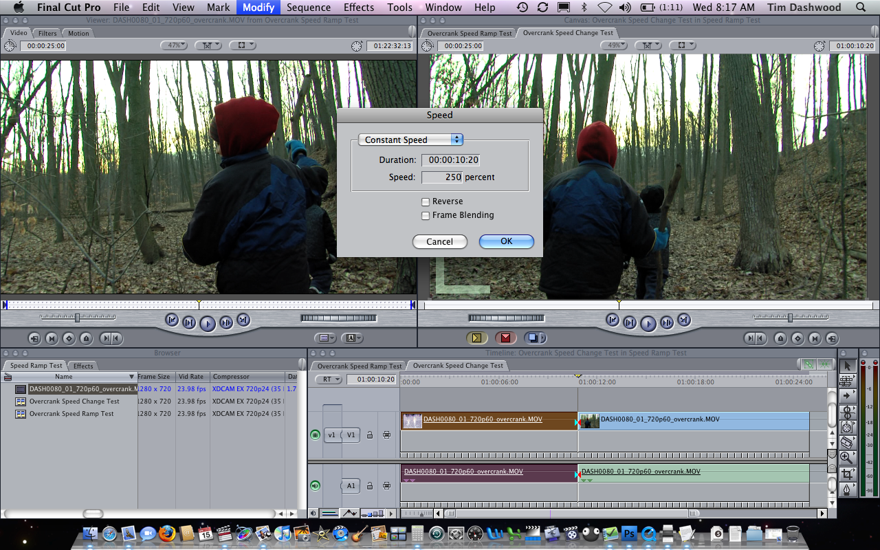

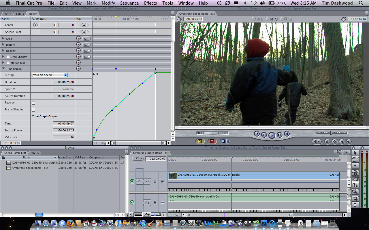

Shaun.
I assumed Rob already had his clip conformed to 24P, either by way of Cinema Tools or in-camera. (I saw a pic of him holding an EX1 on his website.)
The Sony EX1, Sony EX3 and JVC HM700 can all overcrank 720p and write the file to XDCAM EX at 23.98fps.
This is how I did an ease-in speed ramp from fast to 100% speed with Time Remap and a single keyframe. I also included the alternative as a simple sudden speed change by just splitting the clip with the razor blade and changing the speed of the front bit.
Remapping overcranked video in FCP-speedramp.png   Remapping overcranked video in FCP-speedchange.png
