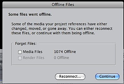

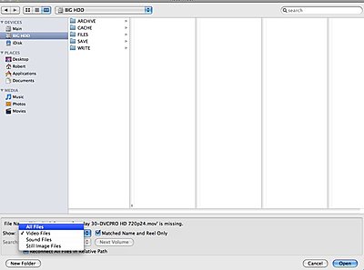

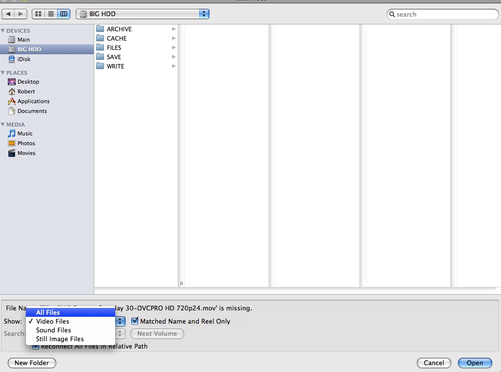

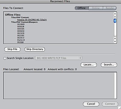

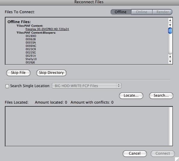

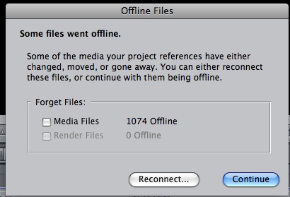

Did you use Media Manager to move or copy the project at all? Do you have more than one version of the project file itself, possibly causing a conflict between new and old versions?
See screengrabs about the process below...
During the reconnect process, make sure you don't accidentally hit the "forget files" radio button. In the rush to find the files many don't read that first screen and instinctively hit the button thinking that "yes, those are the files I want..." and instead FC stops looking for them. If you've accidentally done that and then re-saved your project then that is one reason why you now can't seem to find the files - automatically.
During the search for the files, use the "locate" button and just have FC search the entire drive - make sure "all files" is checked.
If FC isn't able to find the files automatically, use the "search" button and look for the files manually. Use the file-names you see in the timeline to match the missing asset.
If you still can't find your assets after this, let us know.
