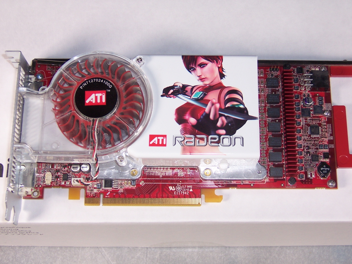

I have since got a 2006 Mac Pro 1,1 and upgraded it (video card, memory, new hard drive) specifically for FCPX processing with the hopes of keeping the MBP from an early demise. Below is a picture of the OLD video card. Note it has it's own dedicated fan and of course the computer has it's own fan too.
A good no-cost item to help keep things running cooler is to access the cooling fan(s) and fins and clean all the lint out. I've done this on several older computers and it's amazing all the fuzz and "stuff" that restricts the flow of air. In fact, if this hasn't been done I'd put this on a must-do maintenance list. One of them was about 85% blocked and the old one in the picture also had a lot of cooling blockage (before being cleaned).
