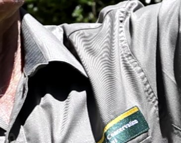

I shot my first paying job yesterday on the 5D mkII, with mixed results. Overall I am pleased with the footage, but I thought I'd share with you two examples of where the 5D mkII can go horribly wrong.
We shot a ten minute interview with a park ranger. He was wearing a simple cotton shirt, which led to moire throughout the footage.
Worse is the pronounced rolling shutter on footage shot from hilltop vantage points. Why? It was a windy day. Even on a fairly robust manfrotto tripod, vibrations caused by the winds buffeting the camera led to.... well, see for yourself :-(

Interesting results, Josh,
Frankly, the moire isn't too bad downsampled to 720p and h.264 re-encoded. I'd imagine that it's a lot stronger on the original 1080 footage.

Hi Jon, while the moire isn't "too bad", it does pop out a lot more in 1080. Given that this was my first talking heads shot, and the subject was wearing a fairly innocuous looking shirt, it's definitely an artifact I'm going to be wary of in future.

So, what tripod/head were you using? We've been too cheap to buy a good tripod so far, and have rented when it was important. I'm curious to know how beefy we need to go for non-ideal conditions. Clearly, the 5DM2 needs more stability than an HVX, but at least it's not near as rubbery as the D90.
From earlier testing, I'd already figured out a monopod is no good beyond 50mm focal lengths, even indoors! With my 105mm lens on a monopod, any small movement sends a shiver through the image.
For this shoot we were out in forests and hilly terrain. Part of the appeal with the 5dm2 is its size, and I thought I could get away with downsizing tripods too. So I left my 516 with beefy sticks at home and trekked up the hills with lighter 755 legs and 701 head. It was fine out of the wind, but in exposed conditions the 5dm2 must be *absolutely* locked down. When those shots were taken, the small movements weren't apparent, the tripod was stationery and ground level, and on the viewfinder it didn't seem to be a problem. I've shot in the same conditions (handheld with OIS!!) with an XH-A1 without incident. It's my first experience with a CMOS camera so the results in the editing room were an unpleasant revelation for me.
Did you have the sharpness turned down or was this the default setting?
I've attached a pic at 100% resolution. The bad news is, sharpness was turned down to 1 (in an eight step range from 0-7). I've encountered the effect to a much more dramatic extent shooting in the city (tiled railway platforms for example). What disturbed me here is that the shirt wasn't the kind we'd normally advise against (no frilly patterns, stripes etc).

1 I am fully prepared to defer to higher powers on this matter, but it doesn’t look to my fairly well-trained eye that the camera is causing the moiré effect. Rather, it seems to be due to the fabric of the shirt (are you sure it wasn’t partly polyester?) and the way the light is reflecting off of it. If not, why are only parts of the shirt banding, and others not, and why is the moiré following the folds of the shirt?
2 The rolling shutter: I don’t see it being the main problem here. This is sped up footage, right? (If not, that’s some serious wind.) What I mainly see is a very unsteady tripod under windy conditions that would look unacceptable, rolling shutter or not. The solution to this obviously is not to "stay indoors" but to get a sturdy tripod.

Hi Mark, I posted the footage simply to assist others with their choices. I'm not a tech-head by any means, but I have owned half a dozen HD cameras without ever experiencing these issues, which I routinely encounter with the 5dm2.
The moire is real, irrespective of this example. Others have posted far worse instances (some quite comical). Whatever the technical explanation for this particular artifact, it's not something I have encountered shooting with the DVX, Z1, XH-A1 etc.
As for the rolling shutter, I can only restate that the perceived tripod movement is exacerbated by the rolling shutter itself, and that I have had no issues shooting in the same conditions (for the same client on the same terrain) with CCD cameras and OIS. I agree a heavy duty tripod would mitigate the issue, and that was partly the point of posting, to help point out what you need with the 5dm2.
The footage was not sped up at all, that was a typical Wellington day :-) I'm used to shooting in the wind; with the same tripod and an XH-A1, wind is not an issue. But I know for next time.
What you're describing is pretty typical. The effect will follow the folds of the shirt, because that's where the critical frequencies are. Where the shirt is flat to the camera, the frequencies will be lower, and where the shirt is perpendicular to the camera, the frequencies will be higher. When the shirt fold is at that perfect angle, the frequency is high enough to alias, but not too high to make it through the camera's optical filter.
The problem with aliasing is that you will get large bands of lighter and/or darker areas. And, yeah, it can look like polyester shimmering. It doesn't matter how much you filter the image or scale it down, because the high frequencies have already been misinterpreted as low frequencies.
With the right optical filter, you'd lose detail on the shirt folds, and the aliasing will be reduced to more acceptable levels. Downscale to 720p, and the result should look great.
