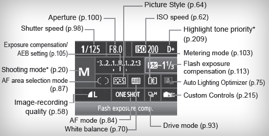

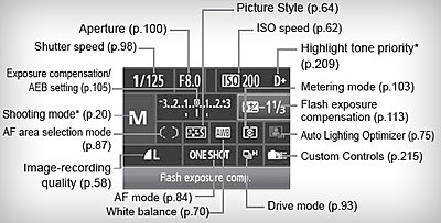

I thought your footage turned out really well, but it looks a bit choppy, did that happen when you were encoding it?
Would you share with me all the settings you used when shooting that video? Mostly the important stuff (I am still really new to all this), such as your shutter speed, aperture, ISO?

I'm not sure if the playback is an issue with how your computers streams Vimeo or maybe how Vimeo encodes etc., it plays back fine on the few systems I have used. I don't know much about this so can't be much help.
Disclaimer: most of what I tried was a result of what I had read on this forum. I'm not a DP so although I could see the logic to many of the recommendations I don't really know right from wrong here, which is why I tried different things. If anyone comes across the links to these suggestions please post them here in this thread.
This was shot at 1920x1080P24, Canon 17-85MM Kit lens.
When I started this I was going to make a note of all the settings while I was shooting, well sorry to say that went out the window in about the first hour. But I didn't go nuts so I can tell you most of what I did although I can't match specific shots with settings.
I shot this over two afternoons, one was bright and the other had a bit of a high overcast. My ISO on the overcast day was 320 and on the sunny day I believe it was 100. I had read that the best ISO's were 320, 640, 1280 and that 1280 should be as high as you should go. Because I only had a polarizer and no ND filters, on the first afternoon where it was a bit cloudy I did manage to get a few shots with a shallower DOF but the majority of this was shot at f/22, I kept the shutter at 1/50 [it should be set at twice the frame rate but the closest shutter speed in the 7D is 1/50] This has to do with the 180 degree motion blur rule, however since there was very little motion in most of these shots I should have tried significantly increasing the shutter speed. That would have stopped it down and I could have had a nice DOF.
I used Apples Color for grading. Instead of trying to match scenes in Primary grading I tried to make sure all the colors where where they should be and get the blacks and grays generally the same and make sure the whites didn't clip. I was more interested in seeing what, if any differences there were in picture profiles. There's a noticeable difference between Cary Grants plane (the first Convair 240) and the B25 for example. With only a few exceptions the Convair was shot with the Standard profile which resulted in a more saturated look, however, it was also shot later in the day, which probably accounts more for the warmer look. For the B25 I used the Neutral profile which gave it more of that "Saving Private Ryan" look. I used the Landscape profile for shots at the Waypoint restaurant and in the hanger which appeared more vivid.
I added the Vignette in secondary correction and some Color FX where I wanted to blur the edges around "Executive Sweet [B25]." There was no vignetting resulting from the lens or polarizer. The vignette is not nearly as pronounce in 1080P and as I have mentioned this was a test to try to shoot anything and to see if there was a noticeable difference between picture profiles. I didn't sharpen anything, this is just how it came out of the camera, which for me was a pleasant surprise.
Here's a link provided by Ray Bell in the "How to Setup your 7D" thread that's worth a look.
I hope I answered your questions. Thanks for watching and thanks for the comments.
