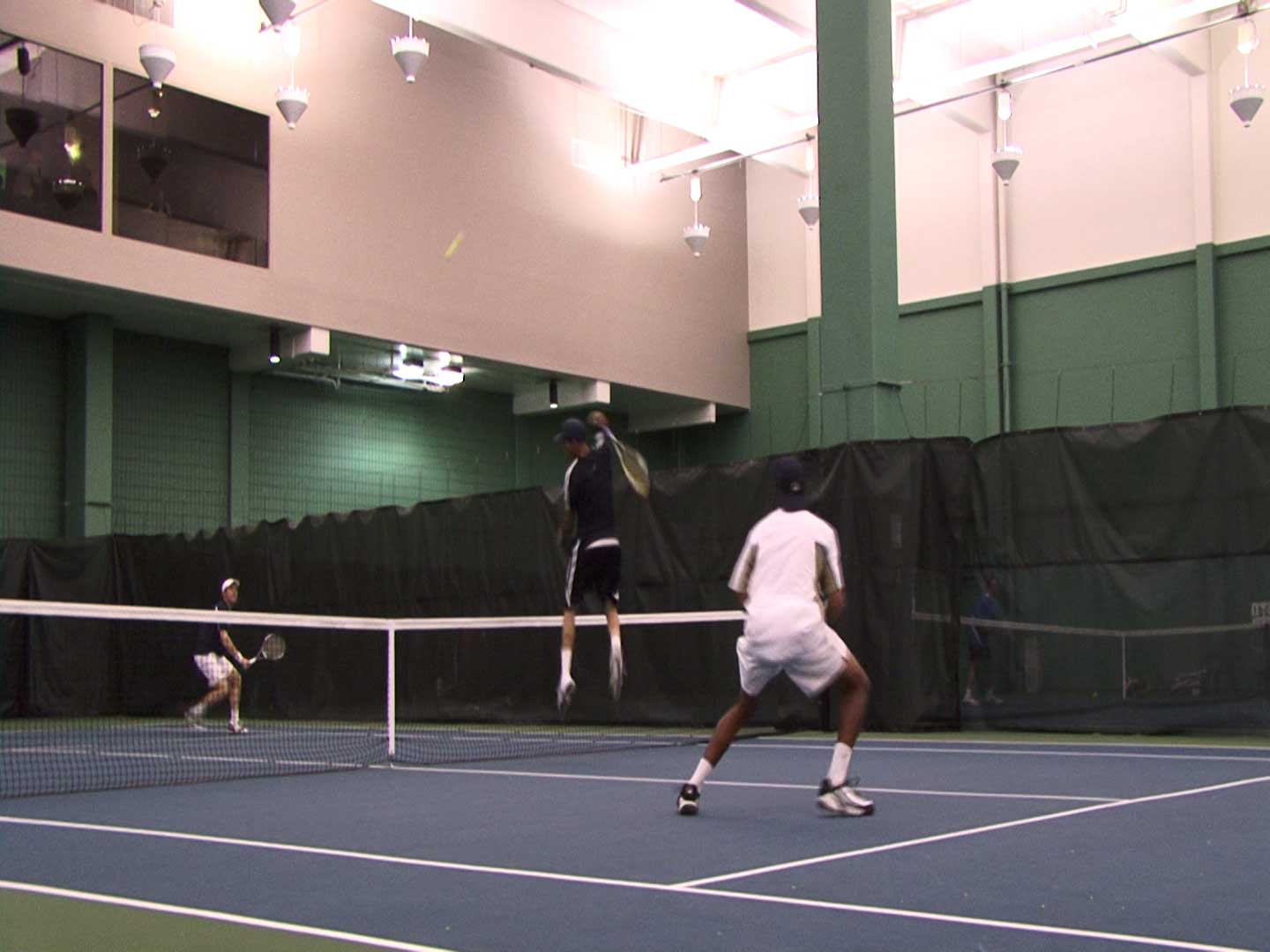

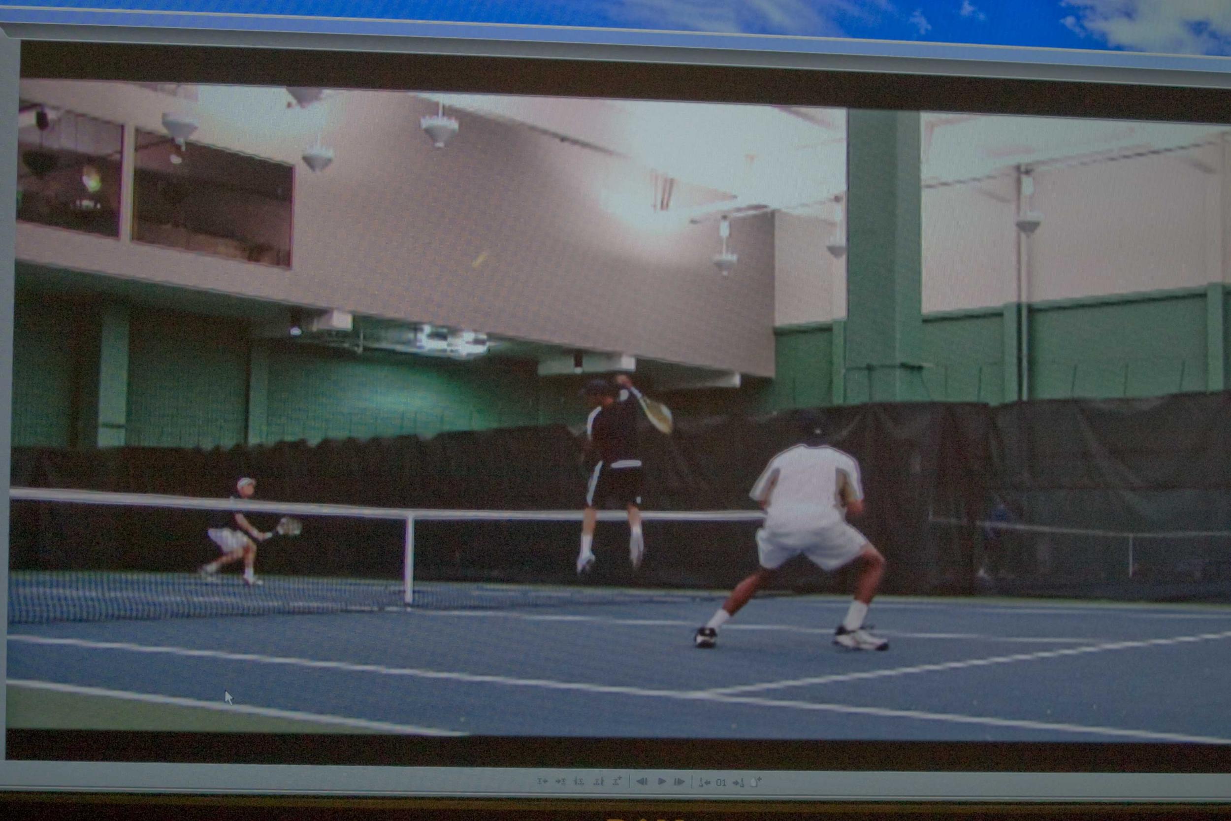

Jaggies
Hi,
I keep forgetting that I can post pics on this site. The following pics will explain what I am experiencing when it comes to Jaggie or the diagonal problem. The first photo was exported from Premiere Pro CS3 looks correct no Jaggies. If you enlarge the first photo full screen you will see that there is pretty much no jaggies or very little. The photo at the smaller size look to me like there are jaggies but no jaggies in Premiere Pro.The original photo was in 1440x1080i. The second photo I took a screen shot of my computer screen of the video in Encore CS3 after exporting the Video from Premiere Pro to VirtualDub using Debug fameserver. This shows the correct amount of jaggies. I then imported the saved avi file from Virtualdub to Encore. I used the following filters in Videodub...
Deinterlace using Blend field method.
Resize to Absolute 720x480, Aspect Ratio Disabled, using Lanczos3
Sharpen by 10
I took this info from one of the messages on this board. I don't remember the persons name to give him credit. It was under the heading "HD to SD DVD interlace questions."
At some point in the process of creating the final DVD I set the Field order to Lower first. The problem shows up on the DVD, also. Although, the problem fades in and out so I think not every frame might be having this problem or frames are being blended together to cut down on some of this issue. Deinterlacing make the Slow mo parts look great.
John Gerard
HD to SD DVD interlace questions-example-no-jaggies-premiere.jpg   HD to SD DVD interlace questions-example-jaggies-encor.jpg
John Gerard is offline   Reply With Quote

It was me who suggested that workflow.
Does the preview in Virtual Dub display those jagged edges on the white lines? It does appear as if something went wrong (almost like a field reversal before deinterlacing). Is it possible for you to send me a 3 to 5 second clip of the original 1440x1080 footage so I can test it on my end?
you can send me an email: jon (at) precomposed.com

Having a clip of the original mpeg format would be better, before it goes out of Premiere through the frameserver. Maybe cut a small clip from the timeline, apply an adobe color correction filter (but don't change the colors), and render it. Now in your Adobe Premiere Preview folder, you should see the clip. Send me an email and let me know how big it is, maybe you can just email it.
Jon Geddes is offline   Reply With Quote
Old May 31st, 2009, 01:52 AM   #24
Join Date: Mar 2009
Location: Seal Beach, California
Posts: 68
Response:
I have just reviewed your clip, and was able to deinterlace/resize flawlessly without those anomalies you experienced.
My guess as to why you had issues is that Premiere's Keyframe and Rendering settings on your export were set to Lower Field First, when it should be Upper Field First for HDV footage.
I am attaching my results to this message.
