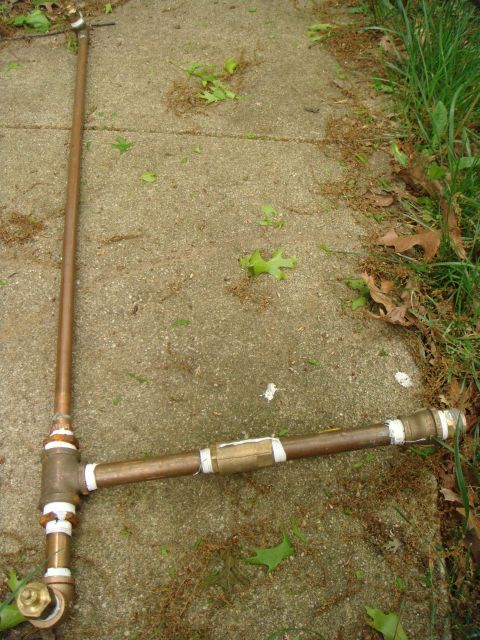

When I get back from work tomorrow I'll try and get a picture of the rain rig my dad and I built. A few half-inch brass nipples and fittings formed a T that had two shrubbery sprinkler heads on the ends, "Rain Jet" I think was the brand. Yet more from the odds and ends the old man's got lying around. Each had a hundred and eighty degree spread, and the intensity could be fine tuned by adjustable stems in the actual heads, or by a ball valve we had on the feed end of the setup. That went into an IPS by hose thread adapter, which then got what I suppose you'd call a gender changer on it, to allow it to then connect to the end of a garden hose. It took hours to design and rework to get the heads in the right place and at the right angle. Unbelievable amounts of time, but of all the things in the movie I think the rain is one that worked out the best, so it was definitely worth it.
The garden hose was attached to a bib in the basement that, just my luck, was part of a line that had gone to our house's sprinkler system, long since disconnected; turns out the line never got capped, and when I went to test it I got a nice bit of water on some of the sundry crap stored nearby. A quick last minute solder job solved that problem, and after we attached our rainmaker to the joists with band iron and cable ties to allow adjustments (not even a foot above the camera with the tripod up so high and on the dolly in such a low clearance space) we went to work.

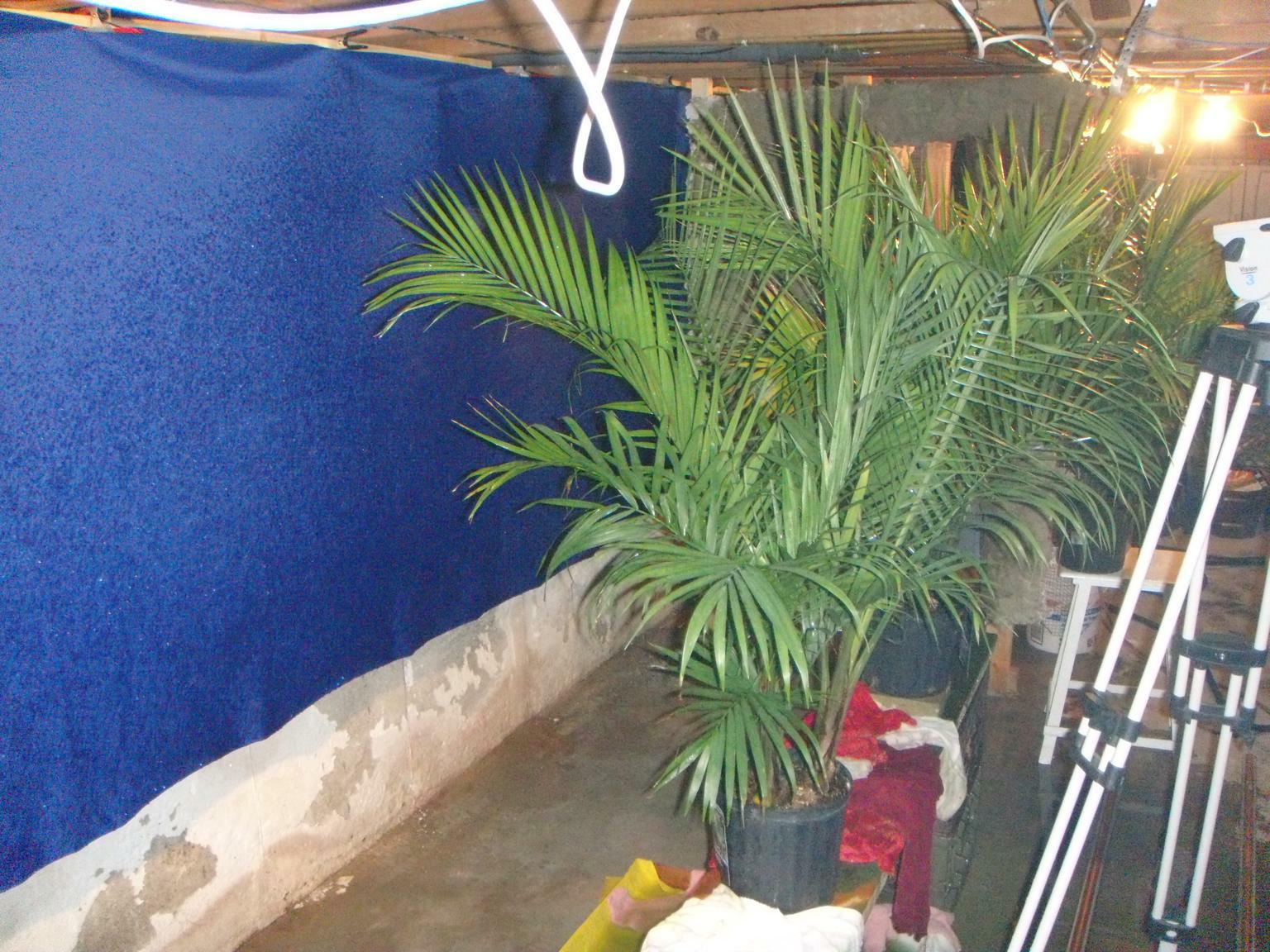

There was a three by five foot copper pan we laid down on the basement floor to try and catch water (lined with rags to quiet the drops, though I ended up not bothering to record dialogue so that wasn't really necessary), but most of it missed. The pan was underneath our foliage table, too--a pair of wooden planks laid across some double high milk crates--and that caught the brunt of the artificial weather. As did my face.
The one worklight I used to light the backdrop was raised up as high as it could be (as part of a cost-is-the-only-object development of the early 70s, however, our basement is only seven feet deep, which made the whole movie that much harder to shoot), as were its cords and the outlet it was plugged into, so nobody got shocked. But hey, it's only 110, right? Real men can handle that without batting an eyelash, so I wasn't worried. The height provided a second advantage in that I was able to clamp a flattened piece of smoke pipe right to a joist, for use as a flag in front of the worklight. My left arm still gets a little light from it during the dolly, but most of my body and all of the plants stay in the dark thanks to that one piece of metal. Real movie lights, with real scrims, flags and filters, would be wonderful, but without money for those I worked with what I had.
The water mostly dried overnight, with a fan blowing on it and some of those plastic moisture absorption baggies hung up around the area, and after another day or two the place was back to normal. I managed to keep the takes short enough, but I did a lot more than I wanted. It's unimaginably hard to act with ice cold water spraying in your face and down your neck, as it was at the end of the dolly shot where I turn to the camera. Six takes of that shot, three of "fantastic" (where we just rearranged the plants, turned off the worklight, and shot from the same position on the dolly as the tracking shot), and another two or three of the over the shoulder where I'm looking at the entrance. The rain coat (which for trivia buffs has the name "Gary" written on the left side in orange marker; yes, I'm aware that an English character would write that name with two Rs, but that's the way the coat came to me) did diddly squat, since with the lantern held in front of me and rain spraying more out than down I got most of it down my arm and neck. I was soaked by the end of it all, which is what I meant when I said I wasn't going through the scene again. I screwed up the "fantastic" shot, though, and the clip you see in the finished film is from a reshoot. It's a damn good thing I redid that stuff while I could, because the cave entrance was destroyed immediately after to make room for the altar (same day, I think, but don't quote me on that), which as you can see from the photos I attached earlier was itself molded onto the end of a piece of the first set's walls. Cracked off some Structo-Lite, snipped the chicken wire along one edge, spun it around, laid it on the floor, leveled it with some shims to stop it from rocking, and built the pillar right into it.
The indoor rain didn't cause the problems pulling keys that you'd think it would, thanks to the other more pressing matters I've mentioned elsewhere. The outdoor rain--the bit with the camera strapped on the lantern--used the same rig, and was shot by some rhododendrons on the side of our garage, though admittedly you don't see any plants in the final footage (I should have walked the other way). I just dropped a Ziploc bag over the camera to protect it from the water and fixed up the contrast in combustion.
I'll get a clearer shot tomorrow, as I said, but for now you can just about make out the rain thing in the upper right corner of the attached photo, above the two lights. There was way too much going on for me to get much in the way of good making of material (though I've got plenty of less-than-good material), but this is the closest. The bluescreen is soaking wet, you can tell I grabbed this shot after production was done for the day.

We'd considered pulling our rain direct from the water heater, since it was right nearby, but that plan never materialized. I don't know if condensation in the lens is a problem only with larger equipment or not, but better safe than sorry.
Here's that closer look at the rain doodad. Initially both sides of the T were the same length, but that put the heads too close together, so we ended up with a male adapter soldered on the end of a piece of scrap copper to widen the spread. The way you see it here is mostly how it was attached to the ceiling; the heads stuck straight up, and sprayed out to what in this photo is the left. Halfway along the piece sticking to the right is the ball valve used for adjustments (the handle is invisible here because it's underneath, directly opposite the camera).
It's a neat little design, and may prove useful on future projects, I'll try to keep it all in one piece.
