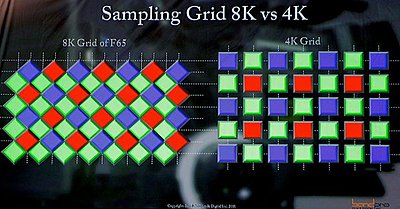

I'm a bit confused? Like I mentioned in the PXW 400 upgrade posts.
If the 450 has a single sensor QFHD/4K conventional type Bayer CMOS sensor once it's de-bayered it's going to have a resolution of around 3.2K... correct?
A conventional 4K grid only has half the Blue and Red sensors so interpolation algorithms are used as part of the de-bayering process to bring up the Red and Blue count.
For example the F65 uses a true 8K diagonal grid to deliver a true non interpolated 4K image. For the 450 to deliver a true 4K from a single Bayer CMOS it's true resolution would have to be well in excess of 3840 x 2160 /4K.
Still confused as to how this camera will deliver true 4K resolution? For true 4K resolution I think they will have to stay with three 2/3" chip RGB style sensors where each chip carries a full compliment of R,G and B in 4K like the HDC series jack mentioned.

Sony PXW-Z450 4K shoulder camcorder-f65s-sampling-grid-vs.-4k-bayer-pattern.jpg

Are we going to see the death of 3 chip designs.....?
Maybe, but for a given size of sensor (say 2/3" in this case) - and with all the implications for lenses that involves - a 3 chip design will always perform better than an equivalent single chip.
With 3 chips and a block, all the light gets used - red, green and blue all get directed to a chip where they get used. That's not true in the case of single chip. For a photosite devoted to red - with a red filter in front - all the green and blue incident upon it gets absorbed, and similarly for green, blue. So it's inherent in single chip design that a proportion of the light doesn't contribute to the picture, or to put it another way, a single chip sensor will always have a lower basic sensitivity, than a 3 chip design of the same size, with all other relevant aspects equal.
Move up to s35, and a 3 chip design becomes impractical, and the much larger size more than makes up for the single versus three nature. But for 2/3", then whilst single chip may be cheaper, it can never have the same sensitivity as 3 chips - expect it to be about 1-1.5 stops worse.
Originally Posted by Christopher Young
I'm a bit confused?
Yes - totally correct!
Still confused as to how this camera will deliver true 4K resolution?.
If it has a single QFHD Bayer sensor, it won't deliver such resolution - end of story. But... does it matter?
The term 4K seems to be used at the moment to define any camera with a sensor of such dimensions - NOT a camera giving "true 4K resolution". And remember such is the same of many other "4K cameras" - right the way up through such as the FS7, to such as the Varicam and the F55. Yes, it's true that F65 will give better results in that respect, but currently a QFHD Bayer sensor still qualifies for a "4K" badge.
