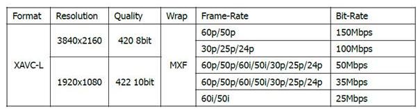

rumors ..*g*.. free of charge firmware upgrade rund up 30th October
The version 3 will include:
XAVC Long GOP* 4K(QFHD)/HD recording capability with max.150 Mbps on XQD media card
TC output from HDMI
*XAVC-L (long GOP) is a codec with MXF file wrapper, in QFHD is 4:2:0 with 8bit, in HD is 4:2:2 with 10bit.
The next firmware version should include AVCHD recording and will be available in January 2015.

Can you please put that image on Imgur? I don't trust a site with a URL like that.
Old October 14th, 2014, 09:23 PM   #386
Location: College Park, Maryland
Posts: 913
Re: Sony launches PXW-Z100 4K Handheld XDCAM
Here's the image from the link.
Monday Isa is offline   Reply With Quote

I have a FDR-AX1 the consumer version of the PXW-Z100. The physical differences are mainly, in typical Sony fashion, SDi and timecode interfaces. The PXW-Z100 is 422 10bit XAVC and the FDR-AX1 420 8 bit XAVC-S. When they came out there were. and still are things that do not work and were promised in a summer 2014 firmware update. There are USB and SD card slots that do not work, data code button that does nothing etc. In this promised update there was also to be included AVCHD and for the PXW-Z100 Long GOP. In this release it looks like they will give the Z100 the long GOP wrapped in MXF that is already in the FDR-AX1 as mp4 !!! As a long time Sony owner I am suspicious that the firmware is the same for both these camcorders just a matter of what is enabled for marketing !!! Just like the differences between the NX5U and the HDR-AX2000. The HD codec is also in the X70, X160 and X180. No mention of any of the interfaces that do not work !! I think the team may have been re assigned to get the X160/180 and the X70 out the door.
Ron Evans
Old October 17th, 2014, 03:30 AM   #388
Location: Burnaby, BC, Canada
Posts: 3,053
Still puzzled as to the 4:2:0 for Long-GOP in 4K. This essentially makes it XAVC-S. But I guess you get more audio flexibility in the real XAVC format rather than XAVC-S.
