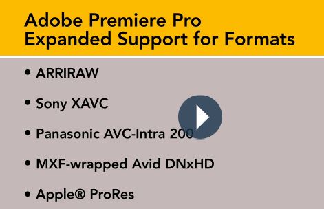

Could someone help me with what is the right way for editing the XAVC clips in PP CC? As per the screen grab below (coming from one of the on-line tutorials), it should be there to chose but - unlike the other listed - I cannot find it anywhere. So I'm using the RED 4k format for my sequences instead, but is there a better way?
Disclaimer: I am a complete newbie to PP; always used Vegas Pro :)
PS. Perhaps the 30-day CC trial has some limitations?

There's no preset for XAVC, but drop an XAVC clip into an empty timeline and it will adjust the parameters to match.
If your using a 50" monitor and you scale 1 to 1 pixels then you are viewing the equivalent of a quarter of the equivalent to a 100" monitor which really is a very big screen. You wouldn't normally watch a 100" screen from just 1m away. It's like watching your 50" screen from just 25cm and I'm quite sure that that close you will clearly see any grain or other artefacts. It also assumes that your software/computer can playback full frame 4K and take a crop and process this in to an HD stream in real time without compromising the image quality.

You're spot on, Alister - I tried to imagine 4x the area of my 50" plasma and came to the same conclusion; were it 100" and UHD, I would back away by another meter or two, which I did. Unfortunately, the black noise was still visible (in both PP and VP)...
Oh, I forgot about the XAVC preset: you're right the PP sequence will adapt, but somehow I cannot find a way to export 4k from PP (neither to a preview monitor, nor to rendered-out media... Please give me a hint as PP newbie :)
Yeah, that's what I did in PPCC and it worked fine.
