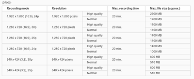

EDIT: Just found this info on the Nikon site.
720p25 is listed....no 1080p25 though. Also, note the info (in the link) about the codec it uses.
D-Movie | FAQ
Last edited by Andy Wilkinson; September 15th, 2010 at 02:21 PM. Reason: adding info on specs

I guess I was too generous on the data rate. Best is 19Mb/s which is not great, based on the 2900 MB file size.

Originally Posted by David Newman View Post
Bit-rate that question has been partly answered by "20 minute movie recording times", as the bit-rate upper limit will be restricted by the FAT32 filesystem (used on flash media) that is 4GB max.
4000MB*8bits / (20minutes * 60seconds) = up limit of 26.6Mb/s.
This is too low for I-frame, but very near the okay long GOP 24Mb/s PH mode of AVCHD.
That would be nice, but I'm afraid it's lower than that. The Nikon FAQ at D-Movie | FAQ says that a 20 minute recording is 2900 MB so that works out to 19.33 Mb/s
