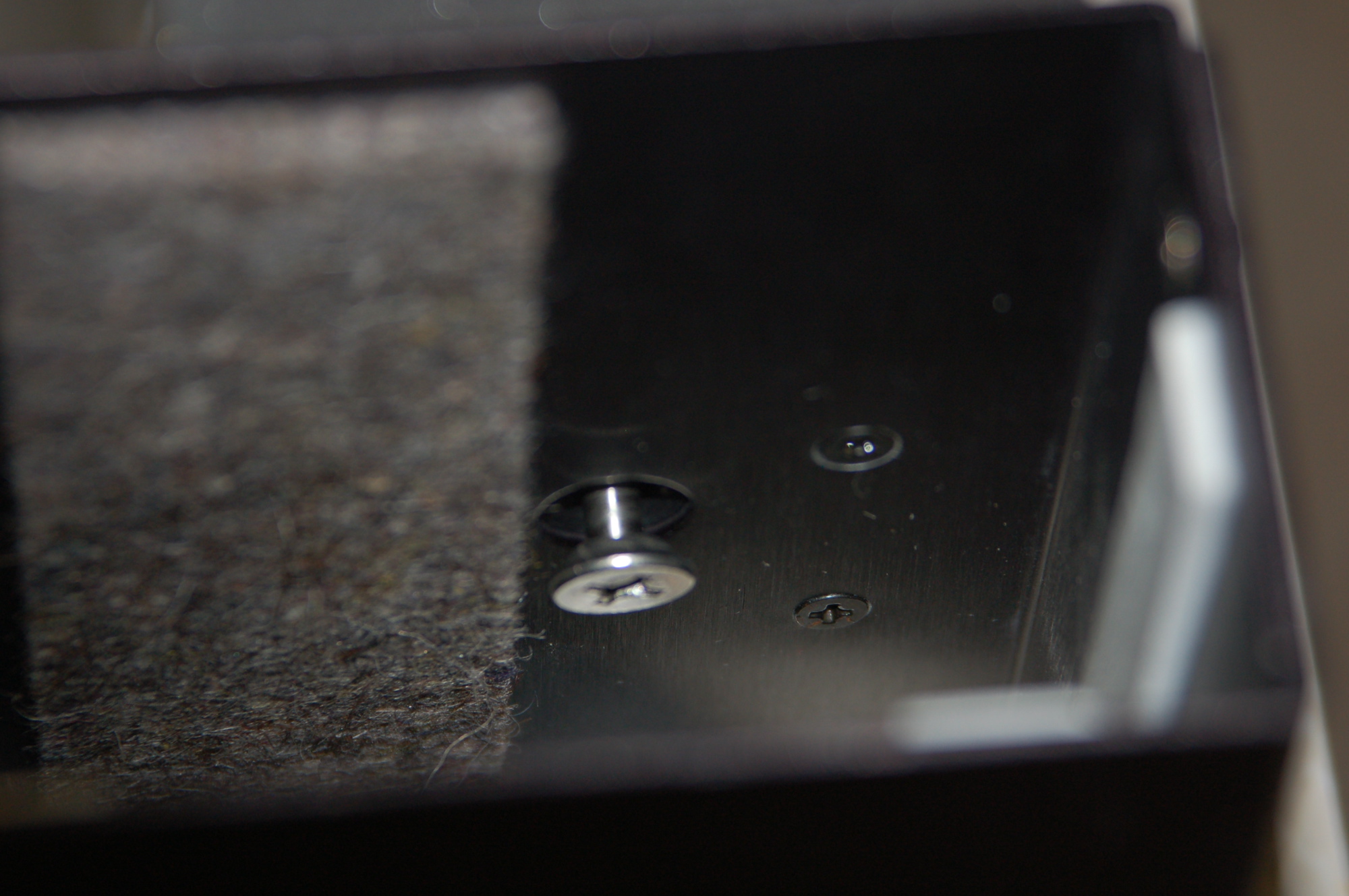

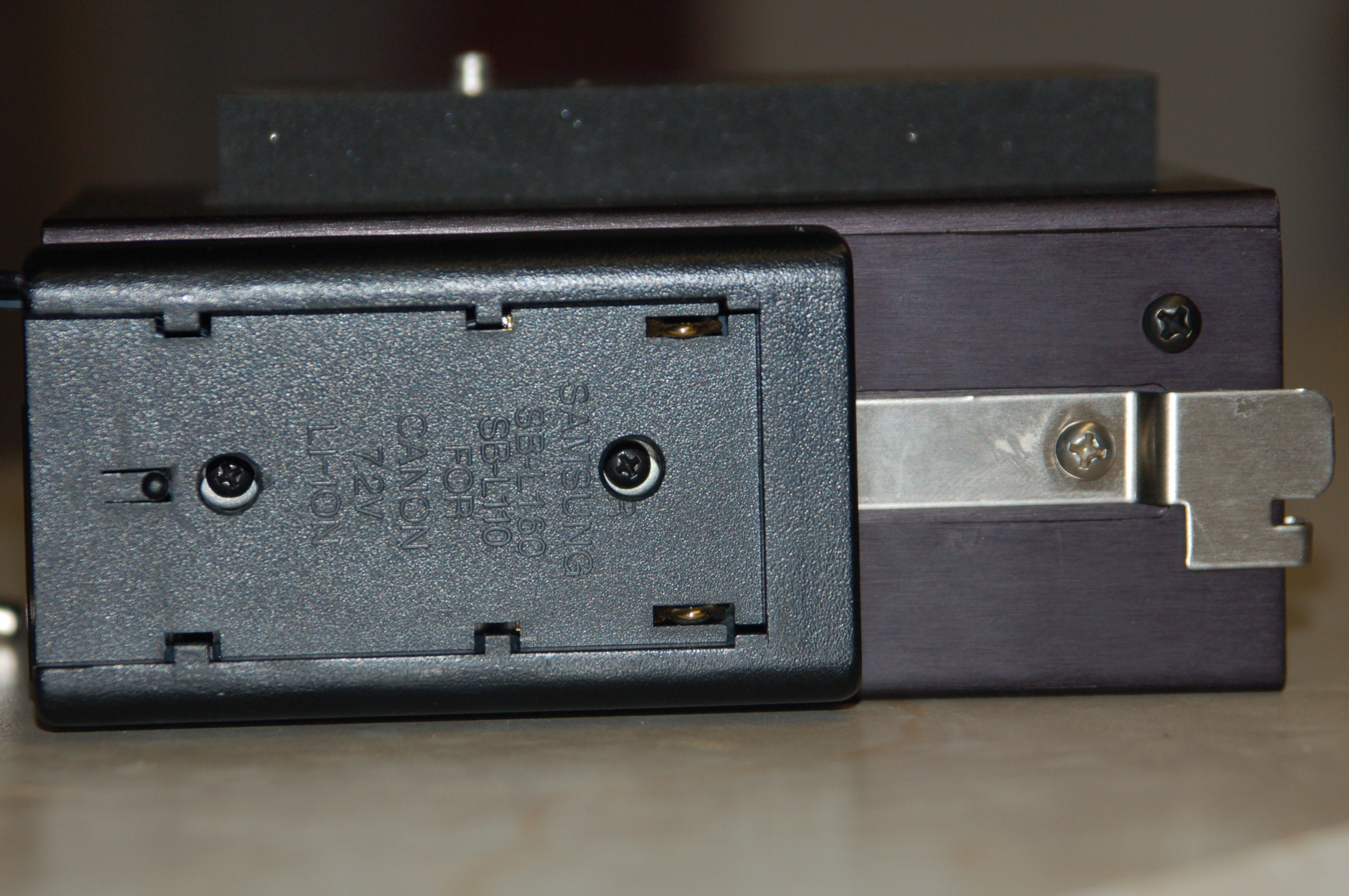

The block you are seeing is what the camera sits on. From what I can tell, yes you can take it off, See attached photo. It has screws which wont be too easy to get to as they do not have their own holes on the bottom to access them from below but you can use the center one if your screw driver is not too big. This would remove the center block, the outer part of the block appears to just be some foam padding that could be cut off. The case its self seems solid but I think it would be easy to drill holes into with any decent drill. There are some holes along the side that are used by a bracket that holds the drive in place but they are on the same side the batter mount is on which would mean you would have to move that to use the holes, however, if you take off the camera block, you could possibly reuse those holes which would mount the case to the camera and leave the batter off to the left.
Over all I have been really happy with the QCHD. I wrote a review on my Website which is also found in the DVInfo Articles :)

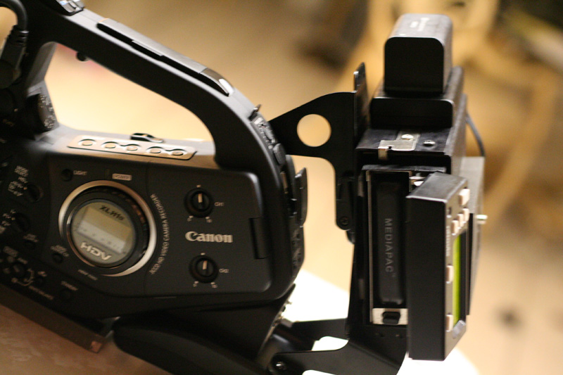

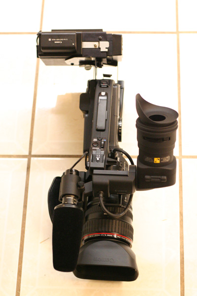

Always welcome. And I have just what you want... or what I wanted... I spinged for a Canon XL-H1A!
http://www.dvinfo.net/conf/attachmen...h1a-xl-h1a.jpg
I will try to add some more. Basically It attaches with a Tripod Screw through the main hold. I need to refine my attachment method but it works.
I bought a standard tripod screw with a wide head so I can screw it in by hand, and a few washers and was on my way.

Josh, I would love to see a top view of your setup so I can see how much is hanging over the Canon mounting bracket.
Do you have to remove the whole recorder from the camera mount to change Mediapacs?

I can change packs without removing it easily and its screen is facing me which makes it easy to control it while filming on a tripod. you could have it take less space going vertical but I liked this setup.

Thanks again, Josh. That's the view I wanted to see. I'm thinking I'll mount mine vertically and maybe then it will fit in my camera bag without having to remove it each time.

I went with the thumb screw to make it easy for removal :) ill have to look at it when home, but if you mout it vertical I think you will be blocking the on off, and firewire and if you mount the other way, you wont be able to open the bay and easily use the buttons.
