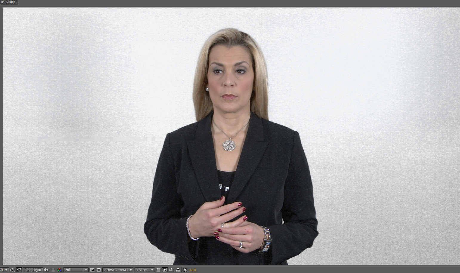

I am sorry to inform you but the EX1 & EX3 are very noisy cameras no matter how the PP is set. I have done extensive testing with my EX1 & EX3 and only after I process 280Mb nanoFlash files with Neat Video and export to Cineform 444, I can start to actually push the colors in After Effects without the noise destroying the image. I have some experience with DaVinci Resolve and I can duplicate what Resolve does within AE, albeit at a much slower pace.
Also, noise and sensitivity determine the actual bit depth. Dan Keaton explained that for every 1bit, you need a clean 6db of sensitivity. With the EX1's measured sensitivity of 48db, there is only 8bits of info available.
The easiest way to see the noise is to shoot a greenscreen and then key out the green with a white background. You will then see the large blocky noise.

Steve, you know very well I'm with you on how noisy the EX1/3 cameras are...
That said, I still believe it'd be nice to capture all 10 bits on the nanoFlash (as we're on the CD forum now, right?). I also am using NeatVideo extensively, and very often - with most noise removed - the resultant images start to show a very awful color banding, I believe that should NeatVideo be run on 10 bit 422 files, the result would be even better!
Before de-noising, those extra 2 bits of (mostly) noise help disguise banding a bit as the image is dithered from 10 to 8 bits.
Also, my little theory is that the noise we see on those large, uniform-color, mid-bright areas is partly due to those 2 bits of color information missing. The fluctuations of current from the photosites translate to very slight fluctuations of the color information; did we have all the 1024 shades of it (rather than just 256), those shimmering stains/blots would not be as striking as they are now...
