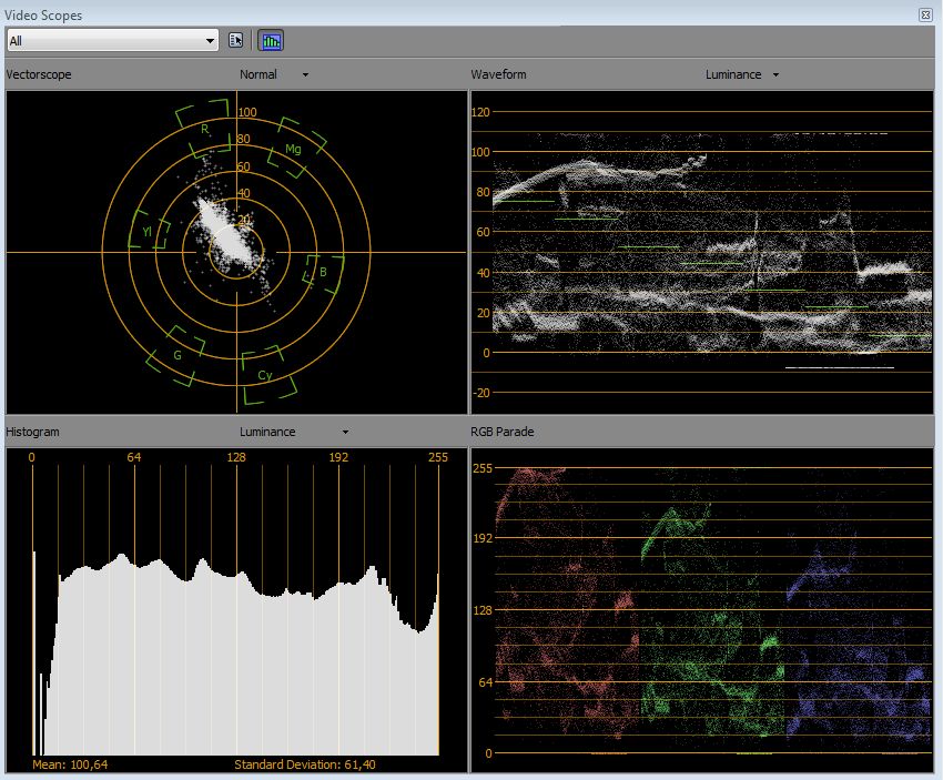

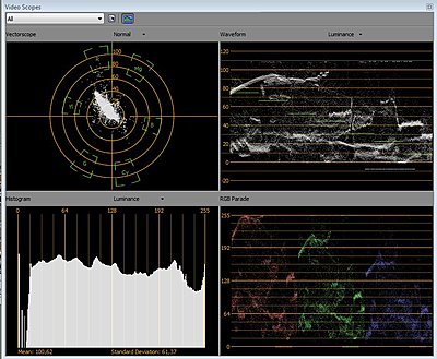

Since this thread is about comments on the latest Beta software, here is some from me - but please do not treat them as ranting :)
After placing on Vegas timeline, and synchronizing by TC, clips recorded simultaneously to SxS (XDCAM EX HQ) and nanoFlash (220 Mbps I-Fo), I have noticed 2 things:
1. The nanoFlash embedded audio is lagging by 4 milliseconds. Not a big deal, but when mixing the two for any reason, there is a slight echo (empty bucket effect)
2. The video scopes differ for the two clips; the difference is very subtle, but if you compare e.g the histograms (take a close look at the very left side, for the blacks), or the Vectorscopes - you will see there IS a difference.
Now a little quiz: which of the 2 pics below is for the XDCAM EX, and which for the nanoFlash 220 Mbps I-Frame, do you think? If you agree they differ, why do you think is that?
I'm very curious about your explanation, cheers
Piotr
nanoFlash Public Beta 1.6.226 Firmware Comments-scopes2.jpg   nanoFlash Public Beta 1.6.226 Firmware Comments-scopes1.jpg
Old November 19th, 2010, 08:11 AM   #34
Location: Incline Village, Nevada
Posts: 604
I'm wondering if the software scope sampling is creating the very slight differences in the scopes? Software scopes use sampling vs. hardware scopes which look at the whole image. Can you see this difference with the naked eye. For example, do you see a very slight deeper red saturation that matches the software scope showing the higher red in the vectorscope shown in your photo? interesting
John Richard is offline   Reply With Quote
Old November 19th, 2010, 08:50 AM   #35
Location: Rhode Island
Posts: 4,048
Could this have to do with 420 vs. 422?

Old November 19th, 2010, 08:52 AM   #36
Location: Poland
Posts: 4,086
Of course this seems to be the only logical explanation, as the 2 pics should be identical otherwise - but does it also explain different black levels?
And, which is which - still waiting for your votes :)
Old November 19th, 2010, 09:05 AM   #37
Posts: 4,048
My vote is lower black 422.

Old November 19th, 2010, 02:34 PM   #38
Sponsor: Westside AV
Posts: 1,365
JPG 1 is 422 is my guess. Seems to show more color and black info. They are very close though, could change that much from one frame to another, because both are compressed.
Old November 19th, 2010, 02:54 PM   #39
Join Date: Jun 2009
Location: Vientiane (Lao PDR)
Posts: 349
Piotr
Thats due to the so call "Presentation".
SxS clips and NANO files use different "Aperture" , so QT display both pictures in a different fashion.
This also affects how FC canvas display the picture, and how look on the VideoScope. The difference is small but noticeable when you shift between pictures.
rafael
Rafael Amador is offline   Reply With Quote
Old November 19th, 2010, 03:14 PM   #40
Location: Poland
Posts: 4,086
Keep guessing guys - this is becoming interesting :)
I won't tell you which is which at this point - but I will inform you that the same can be seen with other nanoFlash formats (like 100 Mbps L-GoP), and with the previous nF firmware...
Old November 19th, 2010, 03:53 PM   #41
Location: Sherman Oaks, CA
Posts: 1,259
My guess is that scopes2.jpg (the first image that shows when you click on the pictures) is the nano. It has a wider vectorscope trace which I think is a result of having more chroma info.
I'm not sure why you say except for 422 the pictures should be identical? They use different data rates as well, so the images should be somewhat different, hence there should be minor variations in the scopes as well.
I am with Olof. Vectorscope shows more color spatter. It should be noted that there is probably a filter on the blacks "in camera" as there is on many CMOS chipped cameras. We don't know how it is implemented so I would suggest if this is going to turn into a debate on Piotr's scope images and the way his camera spits out data that this be spun out into a new thread so this thread stays as a reporting of issues with the firmware in question.
