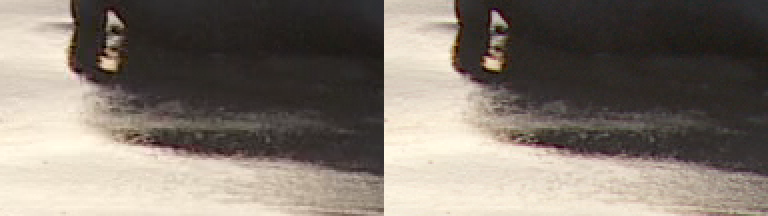

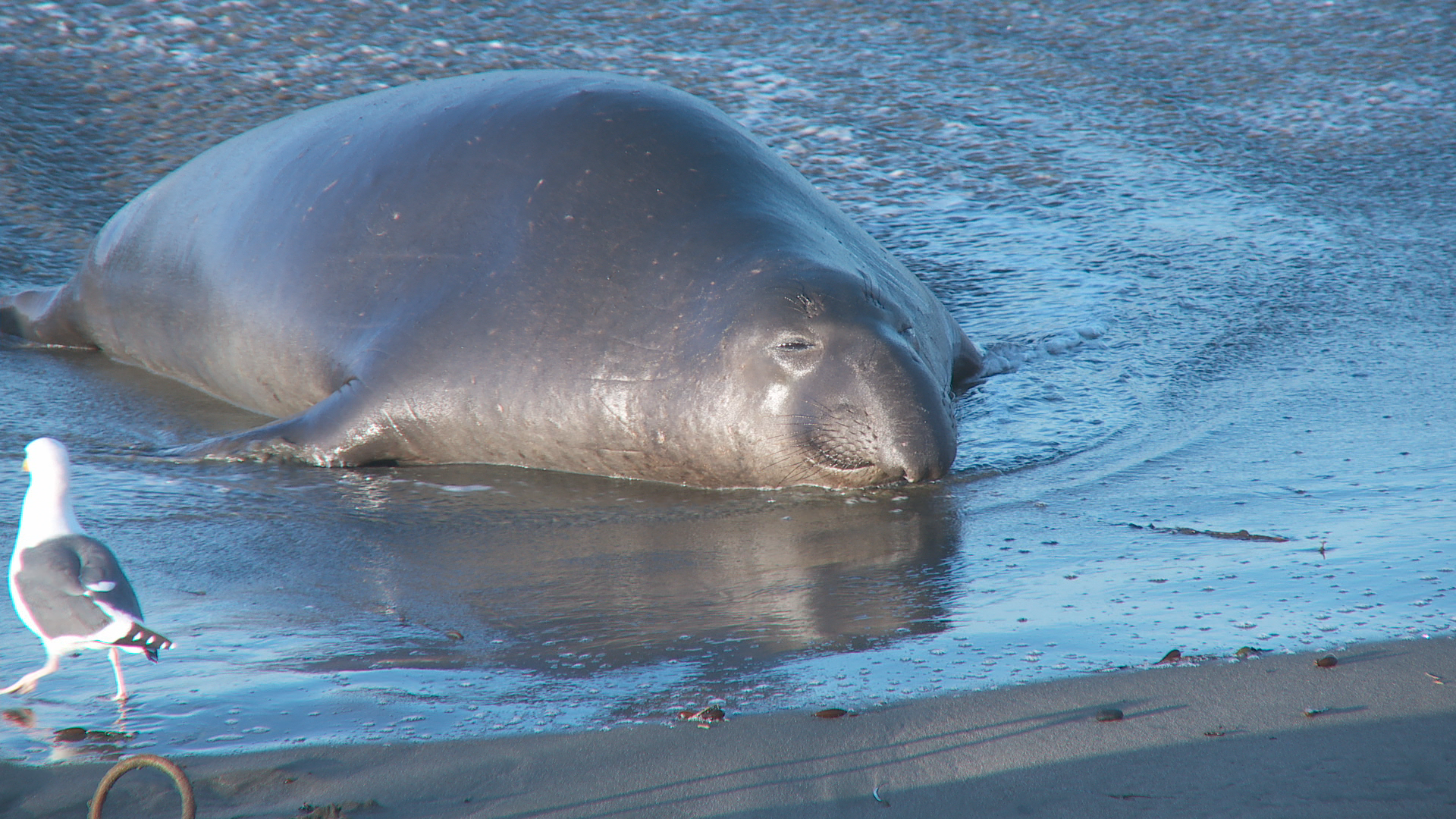

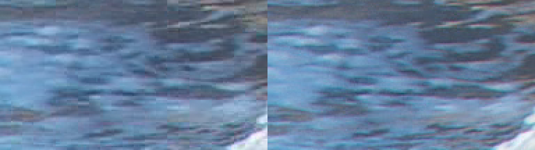

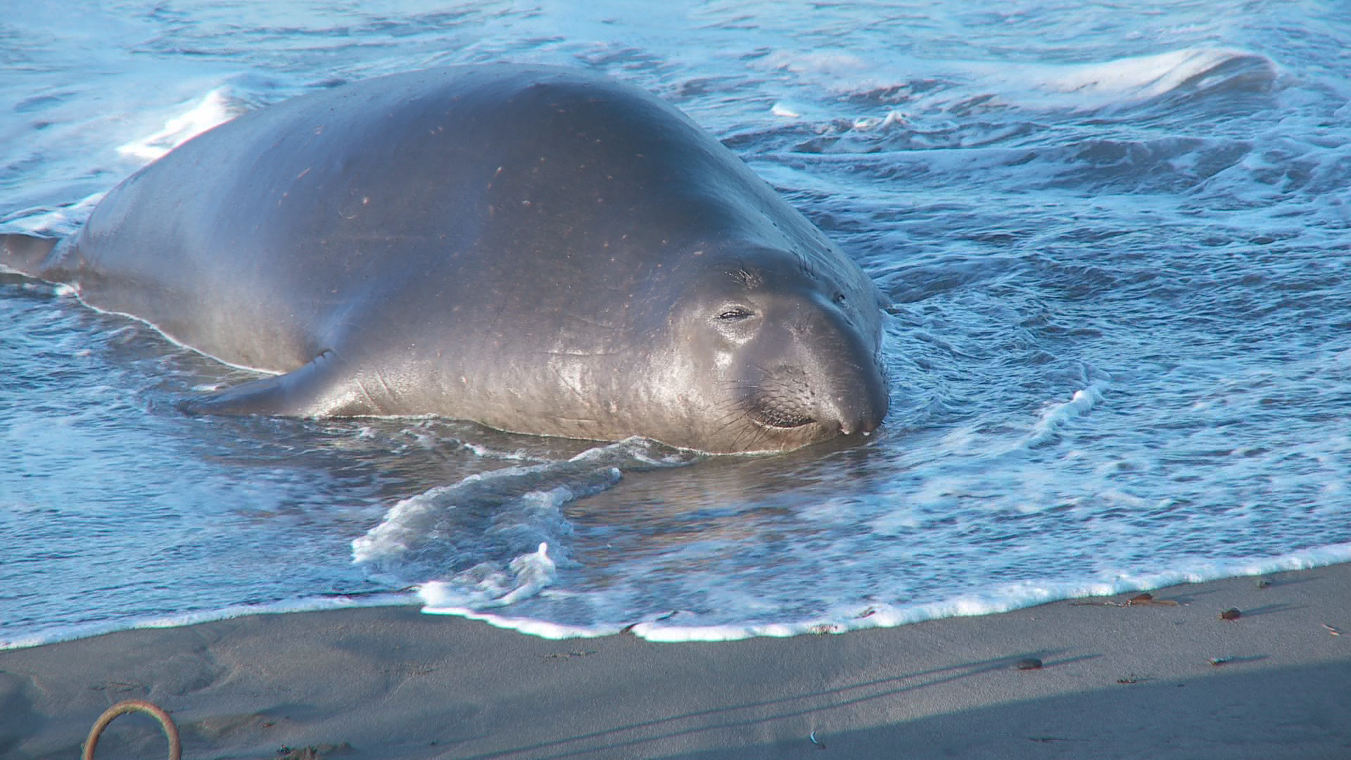

Here are the 1080p30 stills of the same frame from a parallel recording using EX1 and Nanoflash (100 MBit Long GOP). The Nanoflash video looks more "real", and if I fixate on the area below the elephant seal's right flipper, the SxS video appears to have a screen door overlay where the water is quite blocky. I see very little if any such blockiness in the Nanoflash MXF video, and this is what I paid for. The Nanoflash is a good EX1 enhancement for complex scenes as the detail is better, though this scene probably needs more than 100 MBits/second to be indistinguishable from uncompressed video to this eye.
Index of /Videos/NanoTest_ESeal
These are crops that have been enlarged 2x using nearest neighbor algorithm in Photoshop CS4, with EX1 on the left and Nanoflash on the right.
http://www.gentlemensfightingclub.co..._R=Nano_2x.png
Below are the frame grabs. I'm learning that the EX1 is really very good.

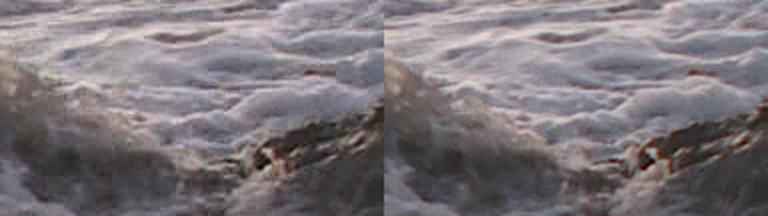

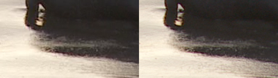

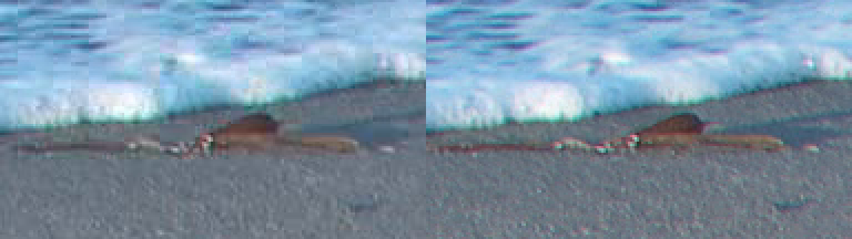

EX1 35 MBits/second on left, Nanoflash 100 MBits/second on right.
I don't know how control the size of the attachments. They seem to show up too small if you don't click on them. So check original files.
SxS vs Nanoflash stills:  Elephant Seals-waterbelowrflipper_l-ex1_r-nano_2x.png   SxS vs Nanoflash stills:  Elephant Seals-wateredge_l-ex1_r-nano_2x.png

Thank you Gints, this is very instructive.

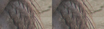

Macro blocking is clearly visible on the SxS cropped picture. The skin of the Elephant Seal is also more detailled on the Nano pictures (look at his nose).
However I think this kind of test would be even more eloquent if the whole picture is moving during a pan or a travelling for instance.

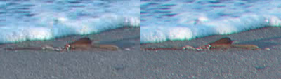

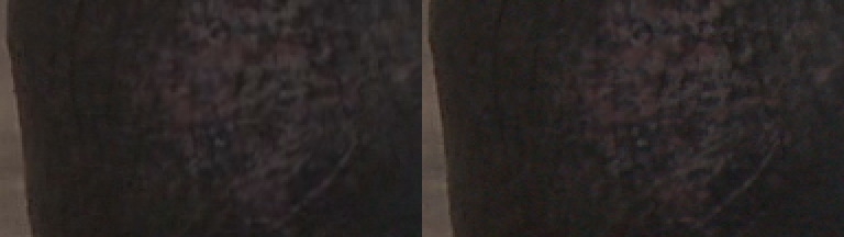

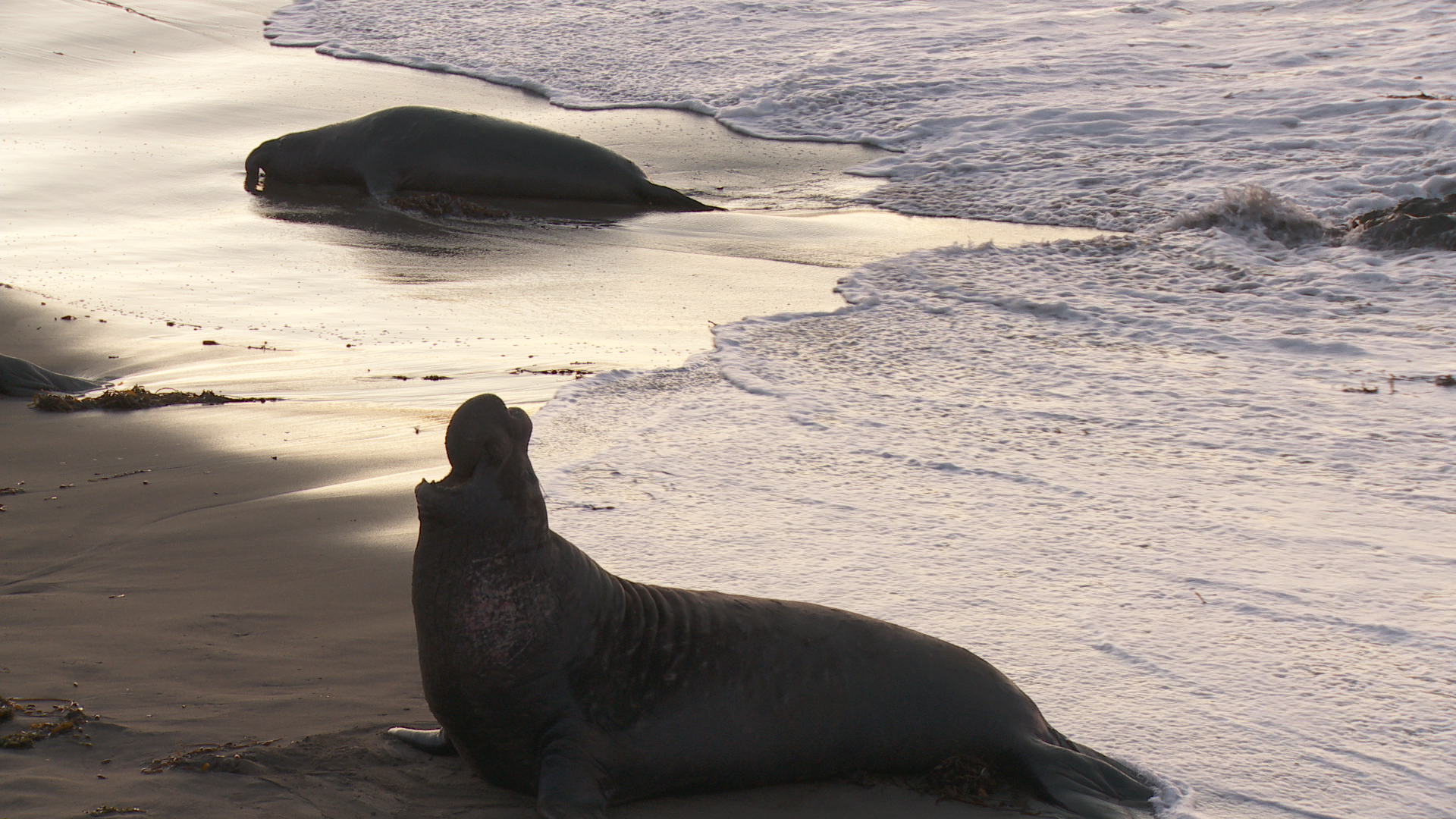

Here's another set of 100% crops zoomed by 2x. Click on the images to show them at full size. To my eyes, it's easier to see the improvement in detail at 100%. The zooms I've provided just don't seem to convey the same increase in detail I see on the frame grabs when they are viewed in full resolution on a 1920x1200 24" LCD monitor. As before, EX1 on Left and Nano on Right.

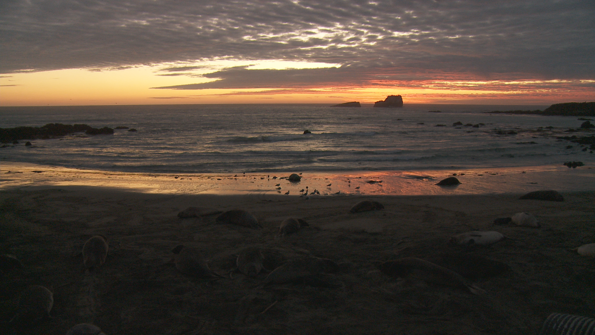

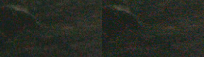

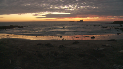

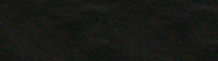

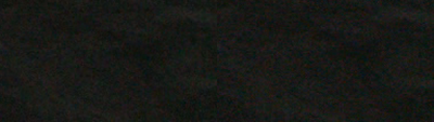

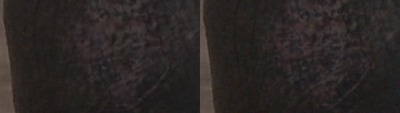

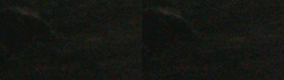

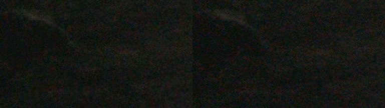

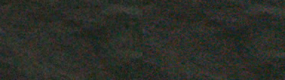

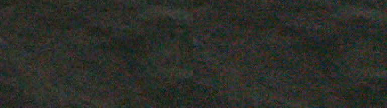

Check out the last two frames of chroma noise in the shadows, shot at 1/60 second at f/1.9 with either +6 or +12 dB Gain. I've added 100% crops from the master image, followed by a lightened image. Does the Nano reproduce the noise more faithfully or amplify the noise? As before, EX1 on Left and Nano on Right.
SxS vs Nanoflash stills:  Elephant Seals-eseal_0004_ex1_429.png   SxS vs Nanoflash stills:  Elephant Seals-eseal_0004_nano_593.png
SxS vs Nanoflash stills:  Elephant Seals-leftcorner_0004_l-ex1_r-nano_2x.png   SxS vs Nanoflash stills:  Elephant Seals-leftcorner_0004_l-ex1_r-nano_2x_bright.png
SxS vs Nanoflash stills:  Elephant Seals-rightcorner_0004_l-ex1_r-nano_2x.png   SxS vs Nanoflash stills:  Elephant Seals-rightcorner_0004_l-ex1_r-nano_2x_bright.png

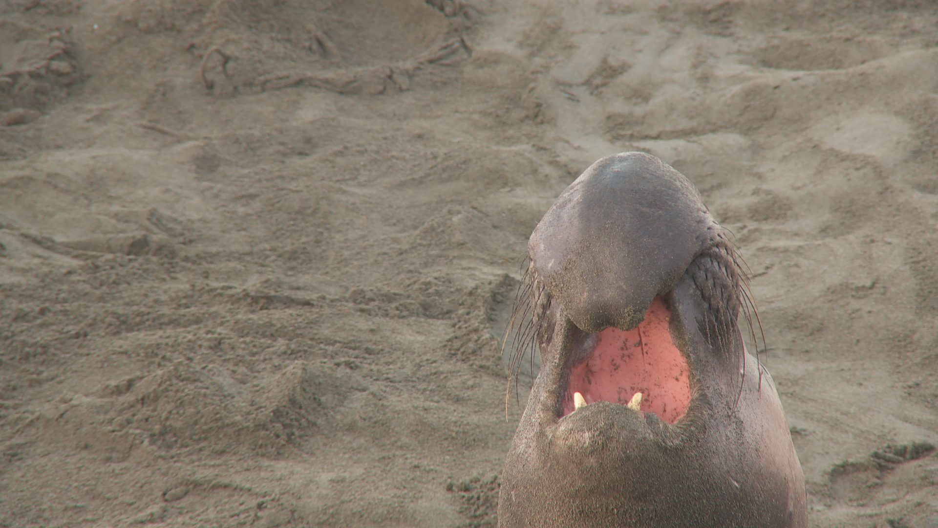

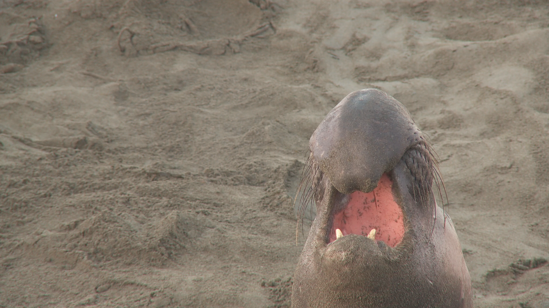

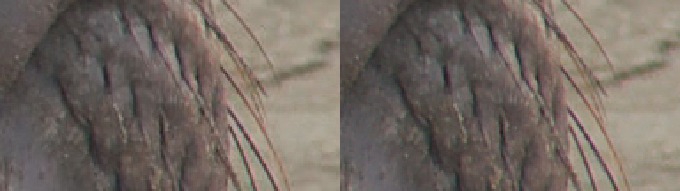

Here's another where I don't see much of a detail difference other than some light compression echo artifacts and a some color difference on the edges of the whiskers. That's ok. Most of the frame is out-of-focus sand. which is reduced in contrast by the visible breath of the seal in the cold air.
Even so, after this frame grab experiment, I will always shoot with my Nanoflash. Life is too short to record visible macroblocks.
SxS vs Nanoflash stills:  Elephant Seals-eseal_0005_ex1_064.png   SxS vs Nanoflash stills:  Elephant Seals-eseal_0005_nano_259.png
SxS vs Nanoflash stills:  Elephant Seals-whiskersr_0005_l-ex1_r-nano_2x.png
