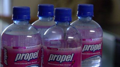

A fairly still shot. Single frame grab. I've been doing some torture tests too but I thought I'd post this (the fine detail on the caps and bottles would be a torture test for HDV).
Straight out of the camera, captured with XDR, no color correction or modification.
Last night I did a torture test by strapping on some rollerblades and skating fast with my camera and XDR with the lens set to infinity and the aperture wide open. It was fun and pretty dangerous too (I don't recommend any hand hold a rig this heavy while on rollerblades). Even flying by objects very fast and doing pans while moving forward, no compression artifacts whatsoever. Amazing really.
Anyway, I promise some footage with some motion soon.

if the link for the TIFF doesn't work. just pull it up from my site:
http://www.vjaswift.com/archive/propel/01085001-60.tiff

Dear Aaron,
Thanks for posting.
I find the Viper images very interesting. The level of detail makes the images very interesting.
I changed the filename to ".tif" so I could open the file.

Old August 12th, 2009, 07:47 PM   #22
Location: Rancho Santa Margarita
Posts: 590
Dear Aaron,
the moving images are so detailed that they look unreal. there's also a fine grain that i find very pleasing.
oh yes, and this is shot with a cheap standard def lens. i can't wait until i save up for a nice sharp high def lens.
