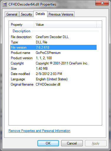

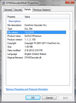

All data shows the black frame issue are solved, but you must run the latest Vegas 11 and lastest CineForm decoders (at least v7.6.2 of the decoder -- which ships with NeoScene 5.6.2 and CineForm Studio ??? 1.1.2.) There was a fault, and it has been clearly fixed, we haven't looped demanding sequences that failed in minutes for days. You may need a reboot between the install of the new components -- something an application hang on the old decoder, preventing a clean update (rare.) The components from CineForm that must at least v5.6.2 are
C:\Program Files (x86)\CineForm\Tools\CFHDDecoder.dll
C:\Program Files (x86)\CineForm\Tools\CFHDDecoder64.dll
Right click on these are select properties to see the version:
