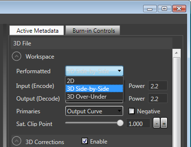

how would I convert the m2ts side by side stereo file to a cineform file?
Using HDLink I'm getting a stereo interleaved file that's just a double of the whole, unsplit, original stream.
Greg Worley is offline   Reply With Quote
Old April 25th, 2011, 03:53 PM   #10
CTO, CineForm Inc.
Join Date: Jul 2003
Posts: 8,095
Re: HDC-SDT750 -> Neo 3D files ?
Use the New build http://www.dvinfo.net/forum/cineform...-neoscene.html
HDLink as is regular 2D file.
In FirstLight open the clip, in the "Workspace" control, change the "Preformatted" type
If you set the display mode to side-by-side before you transcode in HDLink, the preformatted type is set automatically.
