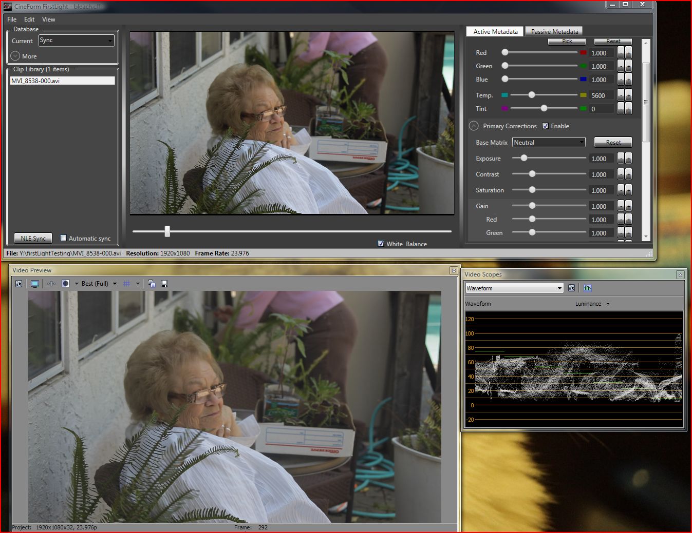

Just for your benefit, the attached photo dipicts a typical difference I am seeing with 9d.

Chris, That picture highlights what I consider to be a bug in the Vegas workflow (as Paul found.) The Histogram shows the black level 0 and whites near 100, yet it displays blacks at 6% grey and white at 92%, if you color correct for the look (and who doesn't) you will mess up your output. Values are suppost to be between 0 to 100, negative and >100 value are headroom, but should not be used in finished output.

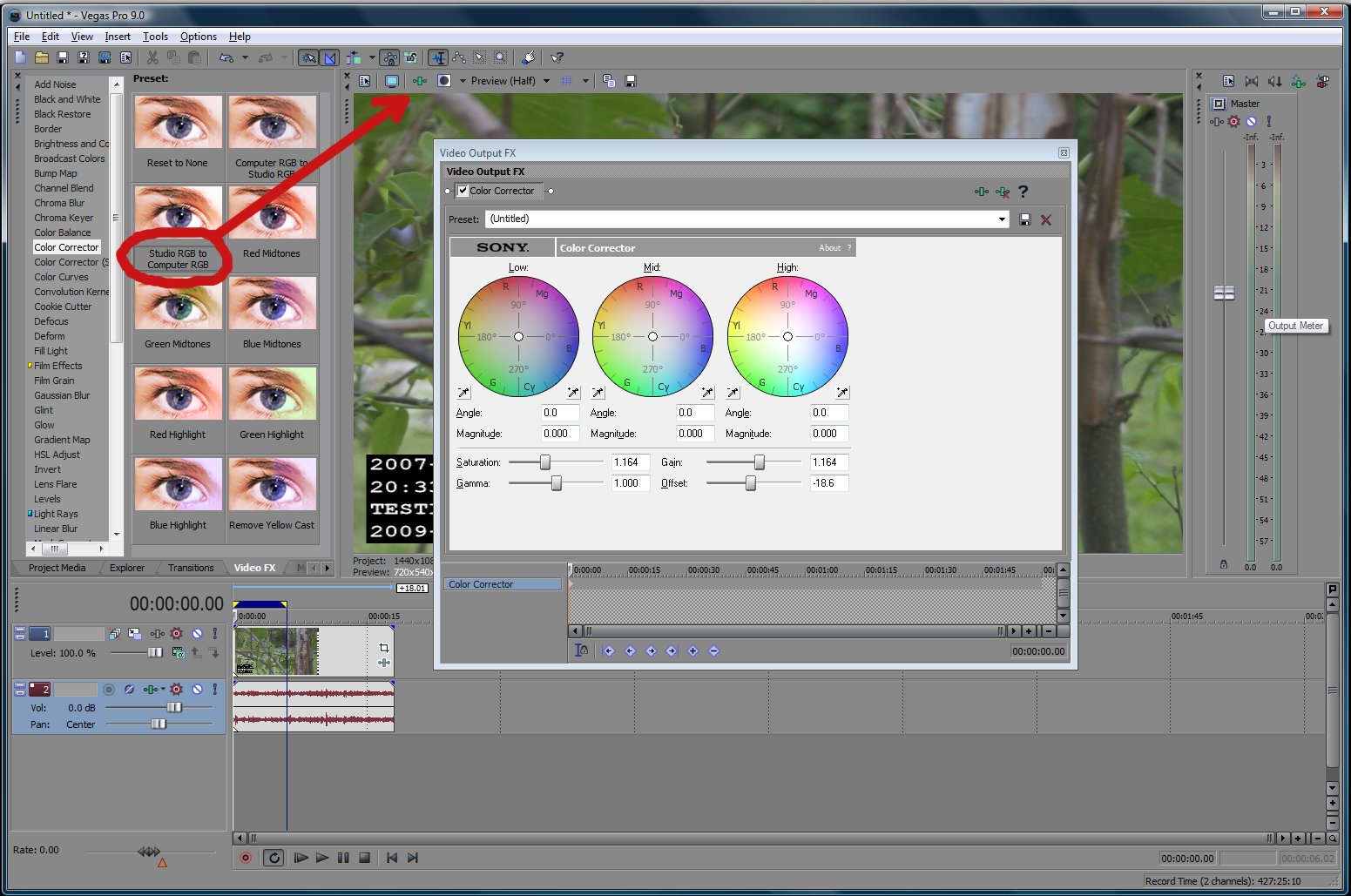

Paul, You can attach the sRGB to cRGB convertor to the preview monitor alone, this way you can color correct using the desktop and not mess-up the outputs.
Vegas9d/FirstLight Histogram Difference-sonyvegas-srgb2crgb.jpg

I just tested this by rendering with the filter activated on the monitor and then the same clip with it off, and Paul is right, you have to turn it off before render because you do endup with the the change being rendered to the final final, and it won't be right.
At least that I now understand the problem, I can adjust for it..
