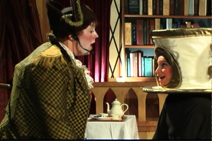

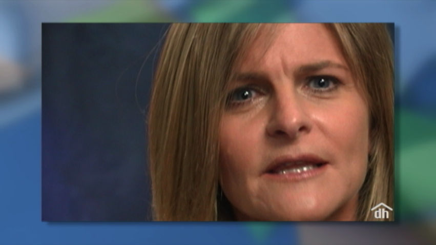

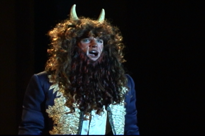

The XL1s is capable of taking decent SD footage. Shooting in Green Box mode isn't necessarily going to give you the best looking footage, especially if the auto gain kicks in. You can learn how to use a camera and maybe take better footage with what you have. You've confirmed that displaying the footage on an SD tube TV using the standard (composite/yellow) cable looks OK. Your "issue", technically speaking, is that it looks different when displayed on a hi-res LCD. If you want to eek out the best possible quality, then capture the footage via FIrewire, and put it on DVD using the highest quality DVD encoding possible (this is another weak link in the chain). Then hook your DVD player up to yout LCD via HDMI or component video cables.
Now a new HD camera will of course take better stuff that, when displayed on the hi res LCD, will look a little better than an SD XL1s. If you are always comparing SD to HD, well...you know the answer.
One of the biggest things you can do with what you have is learn basic photography exposure skills and stop shooting Green box. The XL1s is great that way as it gives you access to the adjustments with nice knobs. Setup the camera like this:
Custom White Balance using a white sheet of paper or grey card
Record mode 30f
Shutter speed 60
Gain 0
AE Shift 0
Make a preset as follows:
Setup -1
Color gain 0
Color Phase +1
Sharpness 0
Shoot in M mode and adjust the exposure wheel manually or for automatic iris adjustment, use TV mode. This will keep the auto gain from kicking in. Add a little light if you need to...it will work wonders. It'll never look like HD footage but it can be made to look acceptable. Here's some screen shots off of some stuff I did with an XL1s.
Poor playback quality on new LCD TV using xl1's-screen-shot-2010-09-15-8.05.06-am.png   Poor playback quality on new LCD TV using xl1's-screen-shot-2010-09-15-8.05.59-am.png
Poor playback quality on new LCD TV using xl1's-screen-shot-2010-09-15-7.59.58-am.png
Les Wilson is offline   Reply
