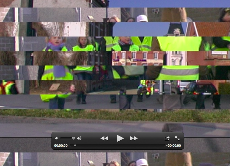

Strange lines/rows when reading the tape from Canon XL1
Can somebody explain this ?
And can somebody help me to avoid it ?
Thank for you help...

Hi Erwin.................
Hmm, well, can't say as I've ever seen anything like it and am at somewhat of a loss to offer a rational explanation with the information provided.
As it appears to be two merged data sets, the first question has to be: "where is the second data set coming from?"
As you know what was previously on the tape (if anything) and what you put onto it immediately preceeding this merging happening, perhaps a bit more explanantion of circumstances would be in order.
If you can reckognise either (or both) of the data sets as having at one time being on the same tape, that would be a start.
Then of course there is the obvious question: Is this data previously recorded but not overwritten when subsequently recorded over, or is it data from the same recording session as the last one?
A bit more info and we might get somewhere.

Simple answer - clogged heads. Probably at the time of recording so the second "write" didn't fully cover the first. Seen it a million times. For those that haven't seen it before, this is TEXT BOOK.
EDIT: ok, not a million but this EXACT phenomenon is why I rail against mixing tape stock as I've had this happen to me.

clogged heads : Thanks for giving it a name.
mixing tape stock : That's what I id before, but for the past 2 years I only use one brand and alway the same type.
It doesn't happen all the time. Sometimes I can do 2 or 3 tapes without the problem. But this time it happens a lot.
Can initializing the tape help ? (Prerecording it with lenscap on)
Thanks for the explanation.

Part of the frame is from the recording before I press the red button, the other part is the new recording. I didn't replace the tape. It's on the same tape that was a blank one from the beginning.

I THINK it has something to do with 2 of the 4 heads on the drum getting clogged and thereby writing 50% of the frame anew... Used to get this with my Sony PD150 if I had to playback client supplied footage in the field. My deck is somewhat more robust but still has had it's "issues" over the years.
Besides changing tape stock, regular run-of-the-mill "dirty' issues such as not keeping cassettes in cases, smoking around tapes, dropping rum and cola on them can also cause clogging so it isn't automatically tape stock. As well, if your heads haven't ever been cleaned, well, tapes shed oxide over time as well and it builds up.
I go OVERBOARD on my heads in my cameras and clean every 20 or so hours but I don't expect to see 2000 head drum hours out of my cameras either...

Erwin: I BELIEVE the information written to the tape is corrupt now, having been written to tape with clogged heads.

How do I a bloody GOOD clean.... I have a cleaning tape. This is what I do...
- Put the camera in VCR mode (playback)
- Insert tape and play it for 10 seconds. Sometime I do this twice...
- END.
But I never do this in REC mode. Because the problem is with the recording and not with the playback.
How do I clean the RECORDING heads, or are they the same...
Erwin Vanderhoydonks is offline   Reply With Quote
Old March 22nd, 2010, 06:42 PM   #14
Join Date: Sep 2001
Location: Northern VA
Posts: 4,496
Unlike the old VHS-based systems record and play use the same heads. Just play a cleaning tape per the instructions.
