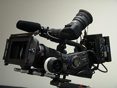

Edirol F1 helps revive an old friend (XL H1)
Well....getting my bags ready for NAB '10. Last year was the first year I missed it in over 18 years !! (lousy economy !).
Anyhow...Although many of you wish Canon had some new, wowie 35mm sized ccd chip camera than ran on a hard drive, or compact flash.....and took 35mm digital lenses (i'm included in the list of these people!). I don't think it's gonna happen. We've known that.
BUT...even though I'm an adopter of early tech, and I certainly love the "less compressed" HD formats...and the nano flash technology out there from Convergent Design...

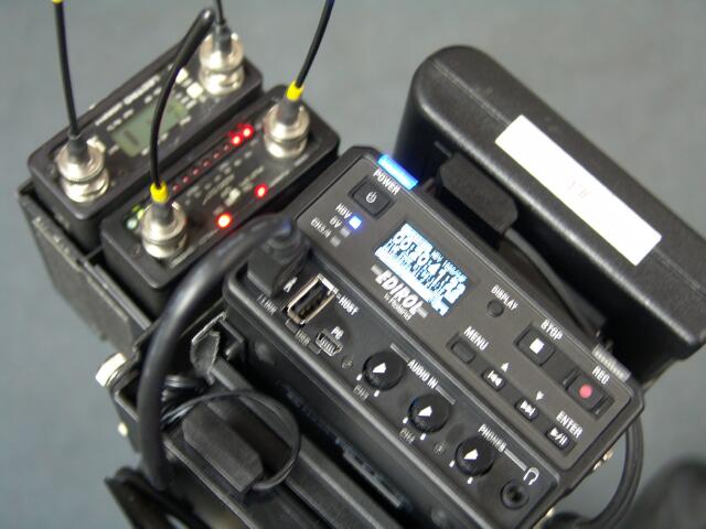

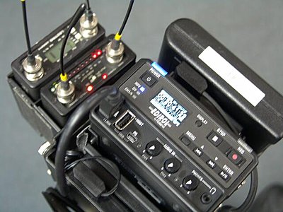

...I purchased this crazy little box from Edirol and I'm giddy about it. The F1 is a box that accepts the firewire input from the H1 and UNDERSTANDS 24 FFFFFF !! Really ! Heck...anybody can do 1080i HDV....but 24F....ha !
It has a 120gig REMOVABLE Hard Drive that is supported on shock absorbers. It can record 2 channels of audio embedded with the video...AND can record 2 MORE channels of UNCOMPRESED audio with it's XLR connectors.
YEAH...it's recording HDV 25mb video...(Edirol has some other box that takes the HDSDI output and makes the F1 record 50mbs...but it can't be attached to the camera easily- cool for studio use)...but so is the HDV tape in my H1.
I've used the HDSDI on my H1 to go to DVCPro100 and it looks GREAT ! Many projects I work on don't need that quality...and the HDV that CANON can record looks fabulous.

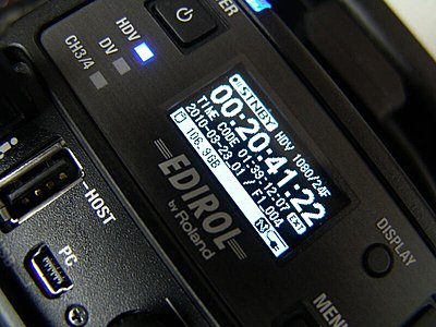

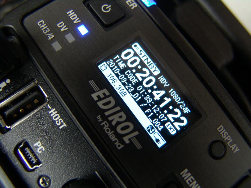

So the problem with ingesting the 24F has now become a thing of the past. We used to use our HV10 as a "deck" with our Avid.
This F1 plugs into the Avid via USB...and Voila ! .m2t files. Version 4.05 of Avid MC sees the files and imports them into Avid with NO problem. AND...the 24f files go into a NATIVE 24f sequence !
Edirol had a great deal on this box....it included the F1, a AntonBauer Gold mount and an additional (2nd) 120 gig HD.
My guess is they didn't sell enough of these...so they may be trying to dump them. But honestly...if you need file based recording...in HDV quality...I've been DELIGHTED with this.
This will give my H1 another 2 years of use...before I have to buy and XDCam HD or whatever is hot in the year 2013 !!

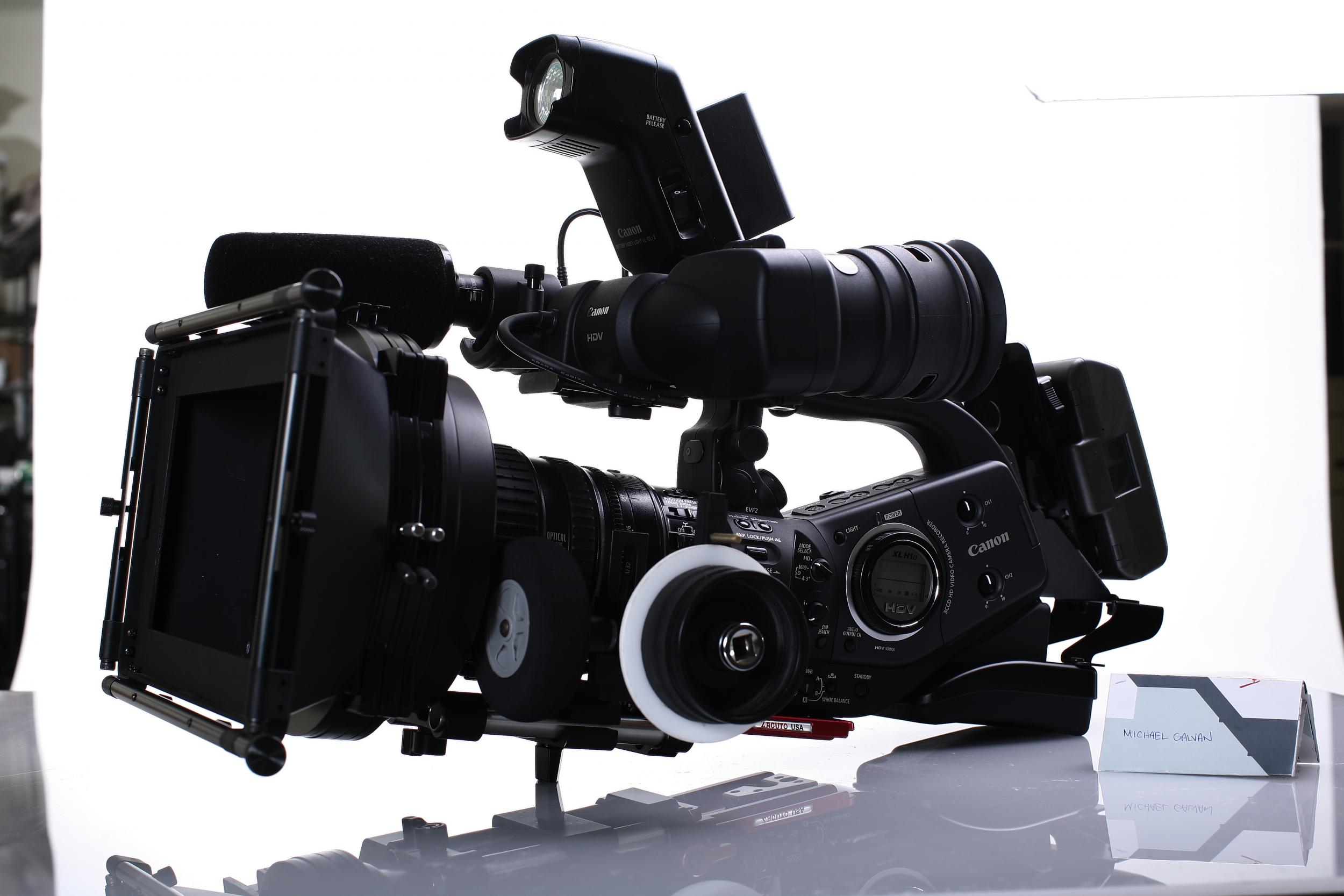

I LOVE my Canon XL H1S, and have been seriously contemplating getting the Nanoflash for it (I've captured a lot from the HD-SDI to ProResHQ and the quality is phenomenal).
Only thing holding me back at this point is seeing what Canon will announce at NAB this year.
Glad to see that this solution works for you!
Here's a pic of my camera setup currently :)
