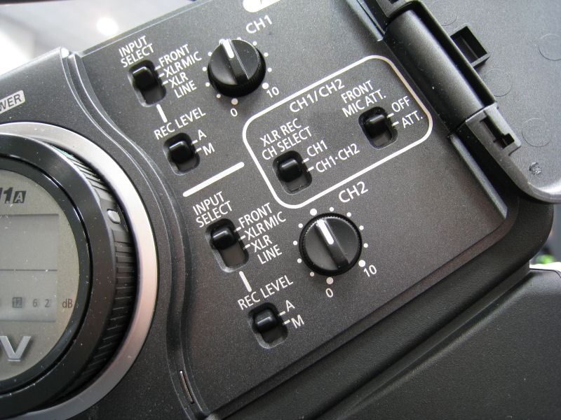

See attached pic.
If you have a mic plugged into the left XLR jack, that is Channel One. On the audio controls panel, set the Input Select switch for Ch. 1 to XLR Mic. Next, set the Input Select switch for Ch. 2 to Front, to record the front mic to that channel.
If you have a mic plugged into the right XLR jack, that is Channel Two. So just reverse the input selections: on the audio controls panel, set the Input Select switch for Ch. 1 to Front, to record the front mic to that channel. Next, set the Input Select switch for Ch. 2 to XLR Mic.

phantom power and y splitters is usually ok, but NOT good practice.
Indeed, and a Y-splitter isn't necessary on this camera anyway. There's a much easier method for copying one channel to the other: attach an XLR source to Channel One, and set the XLR Rec. Ch. Select switch to Ch1.Ch2 which will duplicate the Channel One source over to Channel Two internally, negating any need for a splitter.
