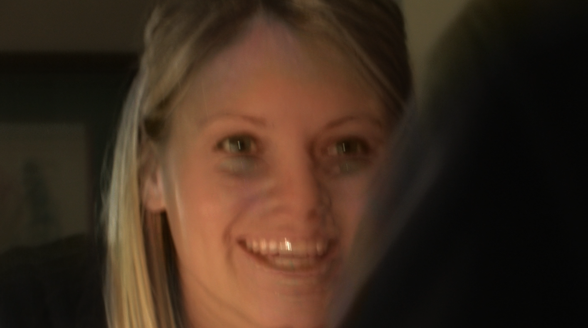

This may not be the same problem, but I've been noticing ghosting as well. I've uploaded a still. This was shot at 24fps, 1080p on the XLH1, shutter at 1/60.
Notice her eye repeated. This is not interlaced obviously, because of the settings above.
It seems to be ghosting and turning it green as well. Any ideas?
I've been shooting with this cam for awhile and it seems to have just turned up recently. Her head was in motion, dipping down, but in full motion its pretty apparent that there is some lag, almost dreamlike.

Posts: 4,100
Did you have NR2 on?
Pete Bauer

Dear Tim,
Ensure that you have NR1 off, as this will definitely cause ghosting.

Can anyone give a reason as to why it would have happened just to the region of the eyes, why not the whole screen?
It jumped on her whole face, it blured where there was motion, the rest of the frame's objects were static. There were still small movements in the other person and when you zoom in you can see a bit of double there too I think.
