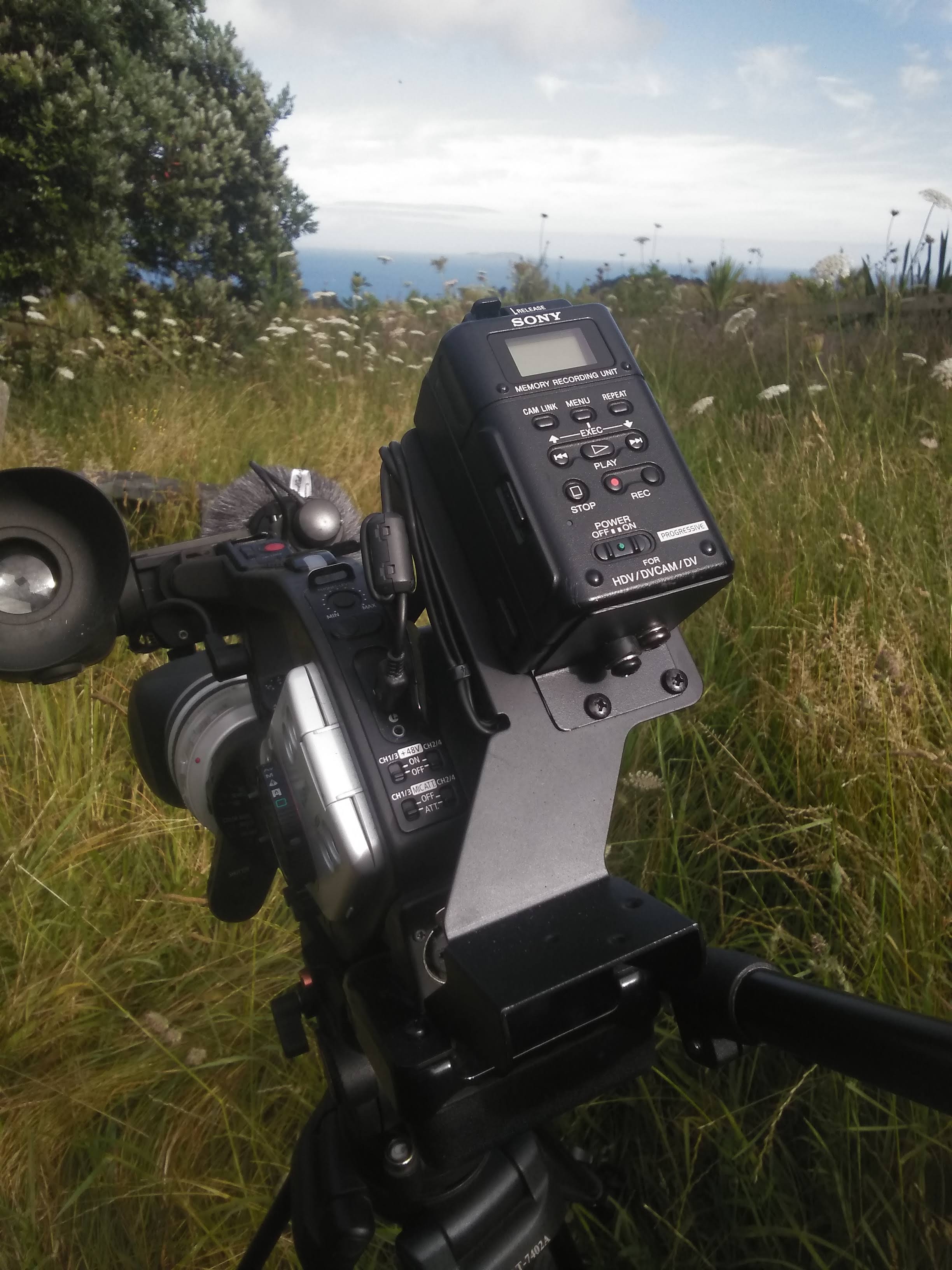

Success!!
I have recorded my first reel and transferred to Vegas Pro V19.
I have the XL2 set to use both tape and the MRC1.
This allows the use of the XL2 view finder display and the onboard controls.
The resultant video from the CF card is excellent, with none of the dropouts and other digital distortions I was getting with the ageing tape mechanism and heads.
I modified the standard XL2 backplate mount for the MRC1.
This involved cutting a slot for the MRC1 battery, and making an L bracket for attaching the support screws.
All parts of the MRC1 can be accessed.
The battery can be mounted or removed without detaching the MRC1.
Attached a picture of the mounting.
I will add a more detailed post separately of the settings I used on the XL2 and the MRC1.

When I saw the quality and control of the images, it confirmed how this camera suits what I am trying to achieve.
Ao Mahana is offline   Reply With Quote
