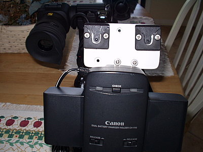

You need two receivers for two transmitters, unless you buy one that has dual channels. The UWP-C1's are very nice and work great. I mount two on my cameras with a simple bracket made from a piece of plastic and two CB Mic-holder brackets. See the picture.
The mic-holders are very inexpensive and are easily clearanced to hold the receivers. That is depending on the ones you find, some need no modification at all.

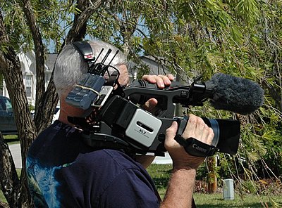

Good luck and I love my UWP-C1's by the way. On the second picture, of my old XL2, the rubber bands are because of the UWP-C1's wire brackets, not the mic-holders. I was banging around Disney World for five days following a family and I did not want to knock them off. They are not needed generally.

Yes, the UWPC1's are the same unit as the UWPC2's, only with the body-pack and lav. Best to get to different frequency ranges. I have 62's and 66's.
Yes, lavs are the small mic that goes on your tie, collar, etc..
I built the holder, as previously mentioned. Just two Citizens Band or Marine radio hand-held mic holders. I think they were two for $5.00. Attach them to anything, even a small piece of thin plywood. I used a piece of plastic.
