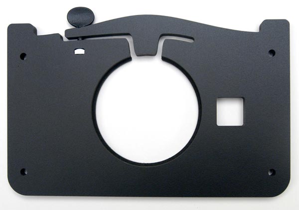

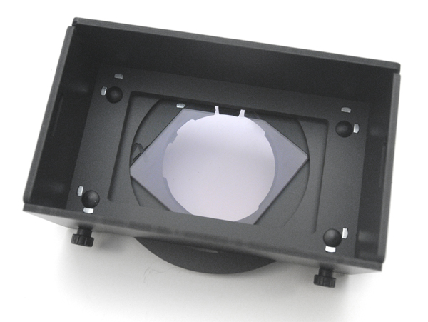

Geardear Matte Box
Hi everyone.
I have received mail from Gerhard as follows.
Hi Trevor,
thank you for your interest in our Geardear equipment.
The mattebox weights around 400gr, with french flag 200gr more. I can not recommed the use of any mattebox with a french flag without rods support concerning the weight on the internal lens mount.
One 4x4" filters alone weights 110gr.! And think of somebody bumping into the french flag or heavy movement of the camera - there is much more force than the weight of the mattebox alone.
Here you see the lensmount with the cutout for the sensor. It is a modified "lensmount80" which fits onto a step-up ring of 72-77mm. The step-up ring you need to buy extra, for example from here http://www.camerafilters.com/detail.aspx?id=776
For the Canon A1 with the AIF sensor we have developed a special 4x4" vertical filterstage. The rotating stage "3sixty" runs exactly through the sensor, so it is not recommeded to use with the sensor.
You can have a "starter" pack with a cutout for the sensor.
The starter-package has no filtertray, so nothing runs through your sensor - except of a corner of the filter sometimes. It is very lightweight and I would use it without the french flag, only with the masks
The size 4x4" or 4x5.65" is depending on how many filterstages you want to use. For the first two stages 4x4" is enough to go full wide.
Hope to hear from you
best wishes from Germany
Gerhard
GEARDEAR.COM
mattebox solution
Gerhard Hirsch
www.geardear.com
Matte Box for XH-A1-lensmounta1kl.jpg   Matte Box for XH-A1-starter1rotatingkl.jpg
