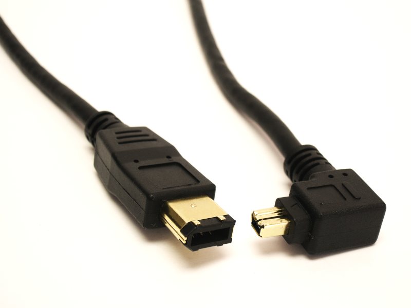

And for that very tiny firewire port there is also a neat solution.....
http://www.usbfirewire.com/Parts/rr-64r01-24gbig.jpg
Angled firewire cables! (left and right angled, meaning: cables goes up or down. I have ordered both!)
Just to protect it against a hit you could protect it with tape. Unless there is a better solution.
I'm thinking about a solution, but did not made one yet.
The big thing about the angled firewire cable: about 40-50% less sticking out of the camera. Reducing the chance of getting a nice bill of 270 dollars. Like Paul did. (And me too).

here is a link to were I just ordered an angled firewire cord.
http://www.usbfirewire.com/fcable64.html

I have discovered it was a 3rd party firewire cable, not one that came with the A! (mine) or the H1 (my bosses). I tried the one that came with the canon's and they fit in better. The hard drive sadly still has issues turning on...so it`ll be exchanged....these angled chords are looking nice...which side would you suggest for the A1?

right if you want it to point down, left if you want it to point up.
If the firestore will be on the camera angle it up, if you will continue to wear it on the belt clip angle it down.
You can see what I mean if you orient the picture of the cord in the mind.
